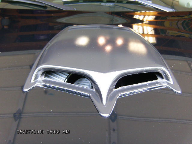

Hey Batman: I promise no more jokes about you "Hanging upside down, and crapping all over the floor" if you'll post a real good picture of your setup, with the hood raised. Thanks "Moon"

After seeing pics of a SSA intake, I can see your point. Too close to hot engine parts. Possible to suck hotter air.[Boy, I'll leave that one alone].
Point I was making was, I can assure you ,my deal, the air does'nt have time to heat up, before it is used. I've had no idle problems and I have no response issues. Runs a lot harder now, before I made the mods. I have made lots of hard road tests, to make sure when I mod something , that it works, or I put it back, like before. Lots of time and effort goes into making sure, I'm doing the right thing. I don't just jump on something, just because it seems popular, and everyone else thinks it the hot thing.

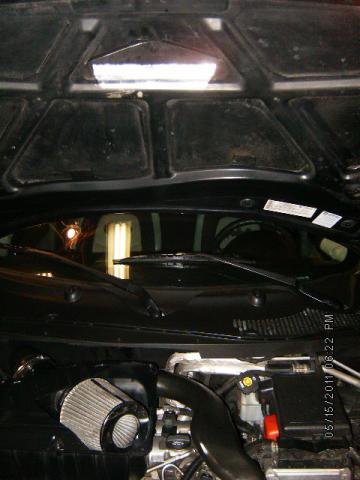

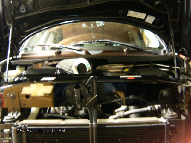

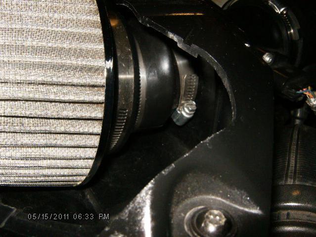

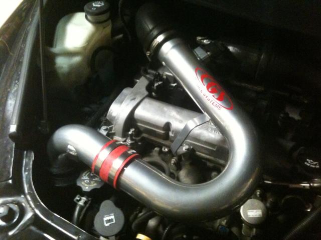

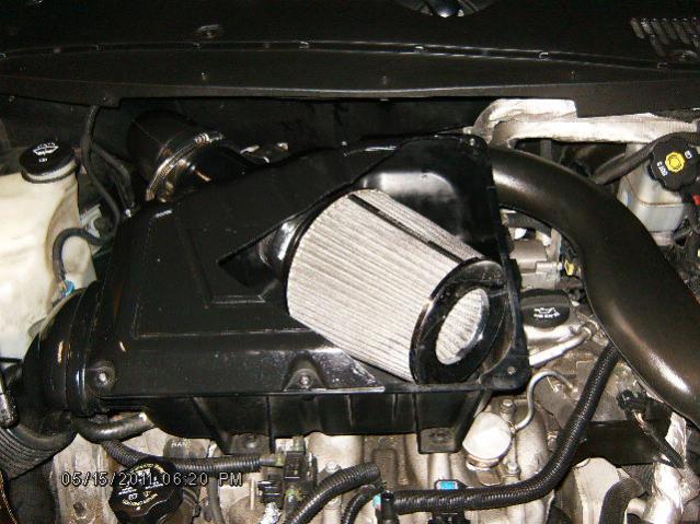

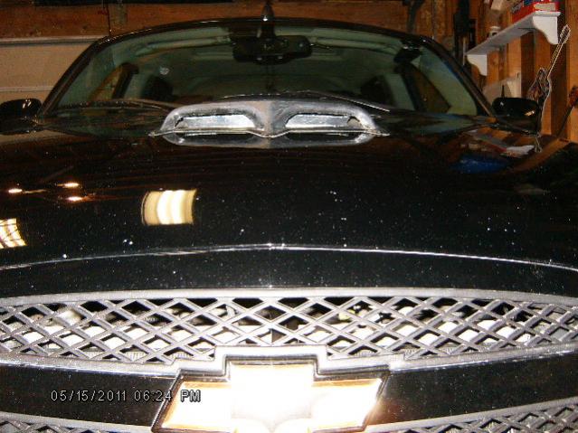

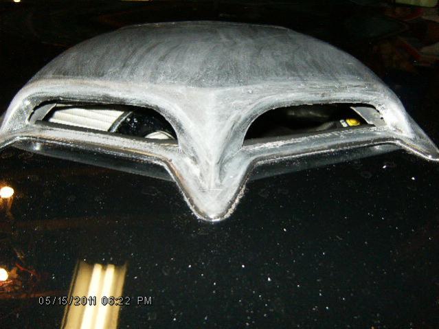

The CGS is a joke , I put it on drove hard for a day and a half, and could'nt wait to put my set up back on . It felt like the engine was sucking air threw a small straw . It's a rare piece . But i'm gonna cut the main tube, and run a filter right under the the scoop opening , and then work on a heat shield that closes off the intake , but flows air threw the rest of the engine. I'm changing stuff weekly, Cause i like my garage .
Hopefully i'll have it right before i get tuned.

One more.
Scoop coming off for a repaint soon (pre prep )

Some day when I get the balls to cut my hood up, I'm going to use the stock air box and install a nacca duct on the hood, mold it into the hood and make a true ram air set up.
I've been getting after vendors and hinting to them on cobaltss.net they need to make a functional hood for our HHR SS air box setup.
I have a flat ram air snorkel sitting in the garage also, just have't had the heart to cut my stock air box up.

I have been thinking along those lines for awhile now[hince the hood scoop now bolted to my hood].
May just jump in, cut my airbox, and make the hood scoop fuctional after all. I've measured and drawn up a setup, cutting the airbox, and having a sealing lip made to the air scoop. Setup I have now, works good, but could be better. "Moon"
