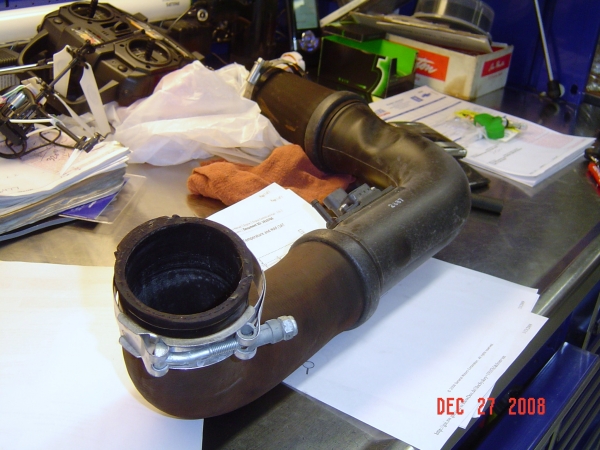

Pics from my install....

Turbotech installed mine and he originally installed his. He found on the HHR's it's easier to remove the Air charge piping from under neath the vehicle so you can do the proper grinding for the anti-rotational TMAP sensor, here's just a few of my pics from the install...GM should have their heads examined, Why would you put in rubber and plastic piping. Yes it is cheaper but well enough said. It's up to us to fix others mistakes. As I always say and will again thanks Turbotech another job well done.
