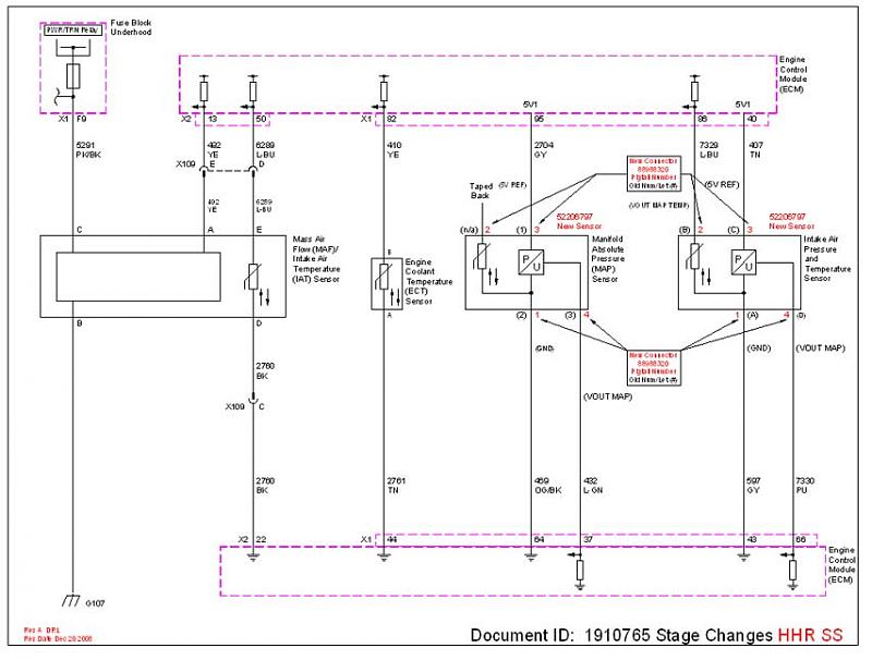

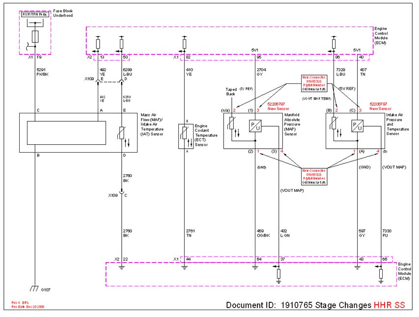

Originally Posted by More_Torque_More_HP
Please Make Sure Your Technician Follows The Pin Out Pictures Of The Sensors And Does Not Try To Follow The Color Of The Wires. The HHR SS Wire Colors Are Different From The Instructions. The Sensor Pin Out Pictures Are Correct In The Instructions. A Bulletin To This Is Being Sent Out To All Dealers.
Bill
I did drawing based on Document ID: 1910765 showing the the correct pin's to wire colors for the HHR that I posted in another section. I will post here and if anyone want's the PDF, PM or e-mail me (dennisloch@gmail.com) and I will send it to you.
Attached Thumbnails GM Performance Parts Turbo Upgrade Kit-1910765-stage-drawing.jpg

Well I think Turbotech needs some credit as well. He called (2 weeks ago) to tell them about the issuses that was going on and that the wiring schematics was wrong... He installed mine today and all I can say is WOW. Turbotech sure knows his CHIT. We also re-wired the DMH electric cut-out and also he installed the TWM Performance short throw shifter. If pics are needed let me know I took like 50 something pics today

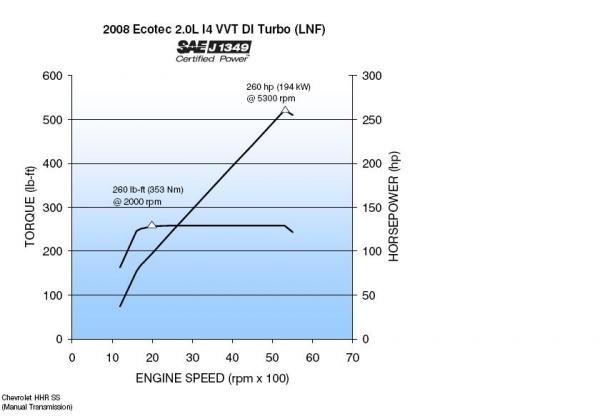

Bill, I would like to ask a favor. If possible could you post a HP/Torque curve similar to this one that shows the stock engine with the stage kit?
Again, thanks for all of your help.
