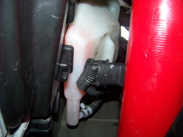

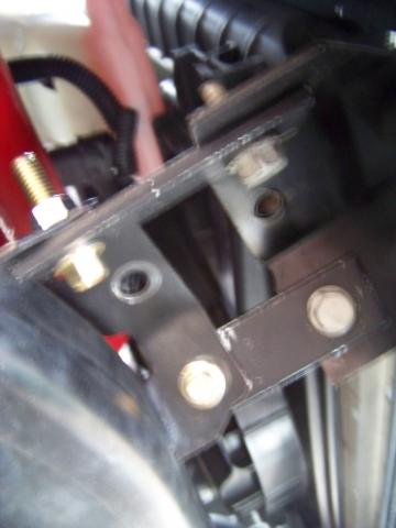

Here are two shots. I had no choice but to do this modification, the HAHN piping in no way shape or form, allowed for mounting of the T-Map any other way. Alot of people just change out the hot-side. I did mine over two weekends. Hot-side first. It wasn't really ballanced until I changed out the cold pipe.
The first one shows the brackets I made. 1/4" strap steel, using all existing hardware. You can get the strap at home depot or lowes and the holes are pre-drilled. I would avoid cheap zinc pre-cut strap brackets, as they are just too flimsy. Also, I recommend painting these pieces to avoid future rust. Looks like I need to touch mine up. You can also see another blury T-Map and its clearance.
2nd shot shows the T-Map turned around 180* and clearly shows about an 1" clearance all around. I have not had a problem since doing this 4 years ago. I think I might have been one of the first people to do this. Also, I think the fact that the piping is steel, there is less flex all the way around, the TTR upper mount also helped. The T-Map sits nicely under neath the overflow container. The radiator is close to the IC but you can still get a peice of paper between them no problem.
I think since I have an '08 the computer is more adeptable to bolt-ons, I almost believe they mucked with the ECM on '09-10, especially hearing how people are adding toys and still only seeing 18-21psi.

Did you basically just unbolt the three bolts
pull the lower radiator towards the front of the car then.
add in the extensions and thats it or did you run into any issues with the radiator hoses or anything else? I should look out for.
sounds like one of those simple jobs but probably will turn into a couple hour deal.
any idea how long you extended the lower radiator out.?

Mike, there are rubber free floating mounts at the top of radiator, so nothing needs to be done there. I just moved mine about 1.5" just to be safe. It automatically transfered this movement to the top posts. there is plenty of play in the radiator hose, no issues there either.
