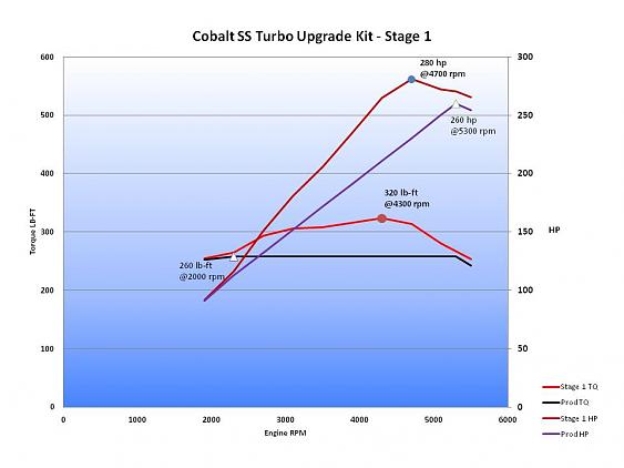

Update on this. I did the same thing as before on the freeway. I was driving on the freeway and was doing 60mph then when I step on it I get 15 psi then I let go of the gas then step on it again and I get over 20 psi. I have a aeroforce interceptor scan gauge and I set it for "current gear" and I noticed that on the 1st time at 60mph the trans stays on 4th gear when i step on it, but on the 2nd time I step on it and get over 20psi the trans downshifts to 3rd then 4th gear again. Maybe this is why we see the different boost levels?
I checked with one of the best tuners (james) about the issue of it not boosting properly when you are cruising along.
James thought it was probably the Gmtune seeing torque and therefore it would not make the proper amount of Torque.
I am pretty positive after looking into this over and over that its clearly the way the tune is designed. I have an email some where from one of the original engineers on this project and the gm tune only adds power during a certain rpm another words it will add power from say 2000-5500 rpm then it will drop back.
I have a dyno sheet that shows this .Anyhow back to the issue where you are driving along at 60 and floor it and it boosts to 15 and then you go back to 60 and then floor it after letting the motor see more than 10" of vaccum I believe is the way the tune is written.
If it was an electrical issue it would not do this consistentley
I would love to be able to drive along say next to an import and then hit it and know it will boost what it should instead of having to let off then give it gas
I reall hope they revisit this issue and fix it in its tune.
Looking back on this issue and as much as it kills me to admit this I think I would have dropped the warranty and tuned it myself instead of putting the money into the Gmtune
or at least had someone hptune it.
Very disspointing to spend 700 plus dollars and have it feel like a dud at times.
I have talked to tom at CED about this over and over and even more_hp_more_torque.
Here is the dyno sheet I believe that I originally received from More hp more torque
this makes a lot of sense as to what we are seeing even though its from a cobalt ss
note that around 5500 rpm the power almost goes back to the power of what a stock ss would make and it appears to do this by backing the boost down in this area
