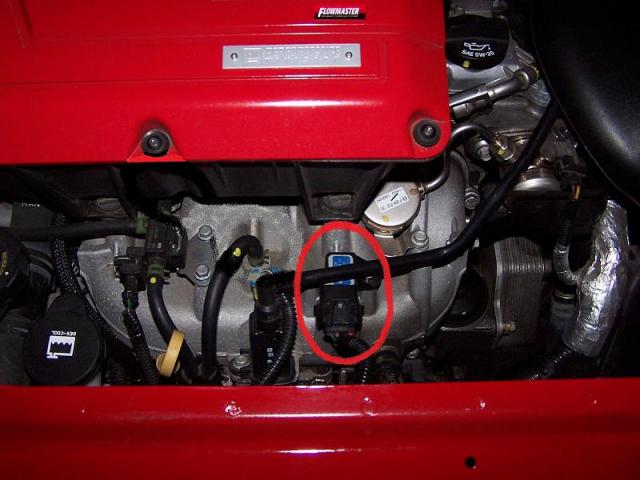

Wheatgerm , as Tara said, check the sensor on the front drivers' side engine. Is the sensor blue or black. If blue, it has the GMTU installed. The GMTU also had a problem when doing heavy footed acceleration. The sensor in the downpipe (that sensor is hard to see) would make contact with the AC piping and set codes. There was not alot of room for that sensor on the install of the GMTU. Installers would normally take that pipe off for the install of that sensor. Giving it a check would not hurt. If there is a GMTU installed.

Thanks ''CokeyBill''.. I'll take a look in that area of things and see what I have, there were no records in the maintenance at the dealer showing an upgrade but that doesn't mean it couldn't have been done elsewhere or by another shop etc..
does this car have the stage 1 GMPP upgrade?
If it does, the MAP sensor will have a blue sticker and be connected with only 1 screw. I can take pictures of mine if you need to compare. You might have the same issue I had when I bought mine. Would drive like an animal and boost to 20lbs+ but would randomly go into limp mode and could only boost to 5psi, or wastegate pressure.
The fix is to remove the butt splice connectors on both MAP sensors and solder them directly. I havent been in limp mode since. Several people have posted pictures on this fix.
the top MAP connector is easy to solder, the lower MAP is a pain to solder. The wires on the lower MAP bang into the AC compressor and short out. So you will want to flip wire routing to point toward the radiator.

Fongue and Fireman George, Cokey Bill and Black Tara, thank you for the information offered, photo too.. Now established it is not upgraded at least so that is out of contention as a problem. My next time working on it will check that lower T Map/Compressor clearance again and while at it it does have 2 screws holding it in with the wiring harness facing the compressor, seemed like it had plenty of room though when I took down all the plastic under it to look it over.
