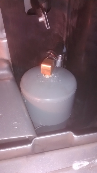

The only good place I could find for the muck collection tanks is behind the bumper cover, one on either side of the radiator. I decided, why not just build them out of PVC pipe and caps?
I should warn you that mounting the tanks was not easy. Squeezing my impact driver into the engine bay, with the hoses, wires, radiator and fan was very challenging. My older, larger DeWalt impact would not fit, but I had a smaller Ridgid that barely made it.

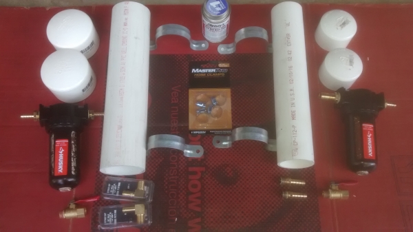

After removing the bumper cover, I could see that I could only fit 2" pipe on the driver side, and 2 1/2" pipe on the passenger side. Here is a material list
1' of 2" PVC pipe
1' of 2 1/2" PVC Pipe
(2) 2" caps
(2) 2 1/2" caps
(4) 1/4" male NPT X 5/16" or 3/8" hose elbows
(2) 1/4" male NPT x 5/16" or 3/8" hose straight
4' of hose (I had some 11/32 pcv hose left over)
(1) 2" 2-hole strap (electrical department)
(1) 2 1/2" 2-hole strap
1/2" self drilling lath screws
(2) 1/4" NPT air shut-off valves (removed from catch cans)
(6) hose clamps
PVC cement
It would probably be a little easier to use 2" pipe and caps on both sides. The pic shows 2 of each pipe strap. I tried to use them as a pair of 1-hole straps on each pipe, but the mount was not secure. Now don't cheap out and get fittings and hose that is smaller. Remember, this is muck, it may not flow real well, it may clog a smaller hose.
These tanks ended up being about 8 1/2" long, you could make them a little shorter, but I wouldn't go any longer. You don't want to be more than about 1/2" above the frame rail, or you won't get the bumper cover back on.
Drill and tap the end caps and build your tanks. Remove the air shut-off valve from the catch cans, and install the elbows loosely for now. You'll fine tune where they point later. Install elbows in the tops of the tanks, and put the shut-offs in the bottom loosely so you can position the valve handle later. Install the 1/4" male NPT x straight hose fittings in the shut-offs.
I spray painted the tanks, but honestly, you can't see them once everything is put back together.
Remove the 2 short rods that the bumper cover screwed to, one on either side of the radiator, and the vertical piece of plastic that the rods poke through. Remove the 2 brackets that hold the top of the radiator in place, and the horizontal plastic piece from the top of the radiator.
Place the 2-hole strap just under the cap, so that the strap will support the tank. You may have to tweak the strap a little, the legs are a little short to reach the frame rail. The 2 1/2" straps are a lot short, but the 3" is too big. This is why I said 2" pipe on both sides would be easier.
Position the tank no more than 1/2" above the frame rail and as far back towards the radiator support as the 2-hole straps will allow. Mark the front hole, predrill, and carefully put a screw in through the 2-hole strap(with the tank in place). If you try to just run the screw in, it will shear right off. Slowly impact it into the hole, you may want to switch to a new screw, or 2, or 3. You may find it necessary to lift the radiator up out of it's mounting hole and push it back into the engine bay a bit to give your impact the clearance it needs. Seems you can only move one side of the radiator at a time. Repeat for the other tank.
Getting a screw in the back hole is very challenging. Forget about predrilling. You'll have to remove the coolant recovery tank to get the passenger side done. I removed the oil dipstick from it's tube, it helped with something, but I can't remember what it was. You'll have to push the radiator up out of the mounting hole again, pushing it forward this time. Do all this and it will still be very difficult, but possible. Get the right length extension and bit for your impact, you may have to put them in the impact after the impact is in place. Trial and error. Don't give up!

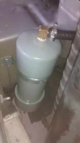

Here is the passenger side tank installed
Once the tanks are installed, you can measure carefully and mark where the hose will need to pass through vertical plastic pieces that you removed from either side of the radiator. Then drill the hole and fine tune, if necessary, with a half round file and utility knife. Here are both tanks showing the hoses installed.
Passenger side
Driver side
And both sides installed. Notice the driver side tank has a straight pipe fitting on the top. I had to change that to an elbow(as I said above) for clearance for the bumper cover.
Now fine tune the elbows in the bottom of your catch cans, and the placement of the handles for the drain valves on the bottoms of the tanks. Put everything back together, the bumper cover, oil dipstick, everything.
Almost done! You just need to hole-saw directly below the drain valves, and attach a short piece of hose, so you can drain the tanks when the time comes.
My 2 1/2" inch tank holds 3 cups of fluid, and the 2" tank holds 2 cups. So with the hose between the tank and the catch can, and about an ounce in the catch can, I have about 26 oz and 18 oz capacity.. I'll put the car on ramps so I can reach the drain valves, place containers under the hoses, and drain away!!

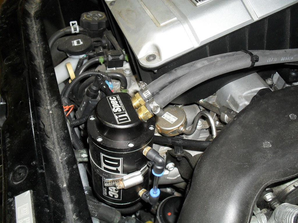

RJ
I took a cotton swab and did both the inlet and outlet of the can. No real oil was present.
I just wiped my finger inside the can walls, no oil.
I feel the mounting of the can is fine:
The inlet runs close to parallel to the engine port and outlet runs down to the turbo port.
The compression fitting is tight, trust me.
As far as vacuum. Vacuum is vacuum. Take a shop vac, holding the hose above your head or at the floor you still have the same vacuum. You only start to have a vacuum differential when in a vacuum environment.
With both of your filters do you see more oil collected from the PCV vs the Turbo?
