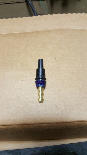

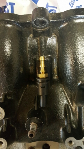

I think 2 cans is the way go. The only way without an external vacuum source. On the K.I.S.S. scale, that's as close to stock as you can get. The wife's been running her car now 2 weeks with only the mini catch cans I made. Running all 1/4" tubing, clean checks, and I'm using the factory intake pcv to handle the fresh air at port 1 (center VC).
No whining and no oil blowing out the filler cap. Maybe I'll open them up today and see what's inside. For science if course!
Here's a shot of the pcv valve mod I came up with. Out of necessity of course. I forgot the housing I made for it at work and just wanted to get the car running and out of the garage. I had an extra 1/8NPT fitting and threaded into the IN side of the PCV valve. Sealed with RTV and a piece of shrink tubing. Looks better then the large housing I had for it. I wonder if I can purchase just the PCV from GM..here's a pic
