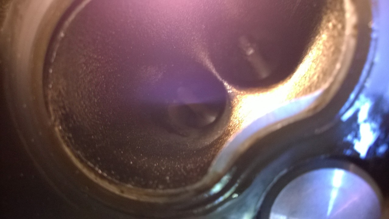

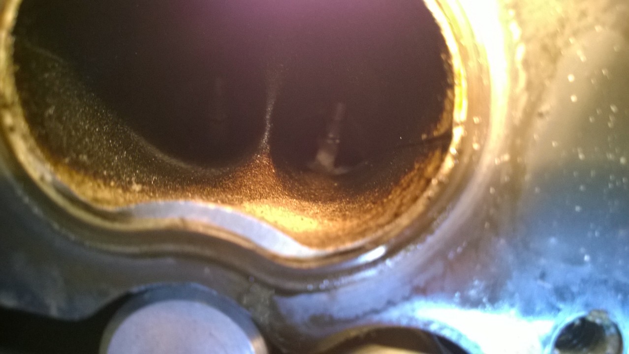

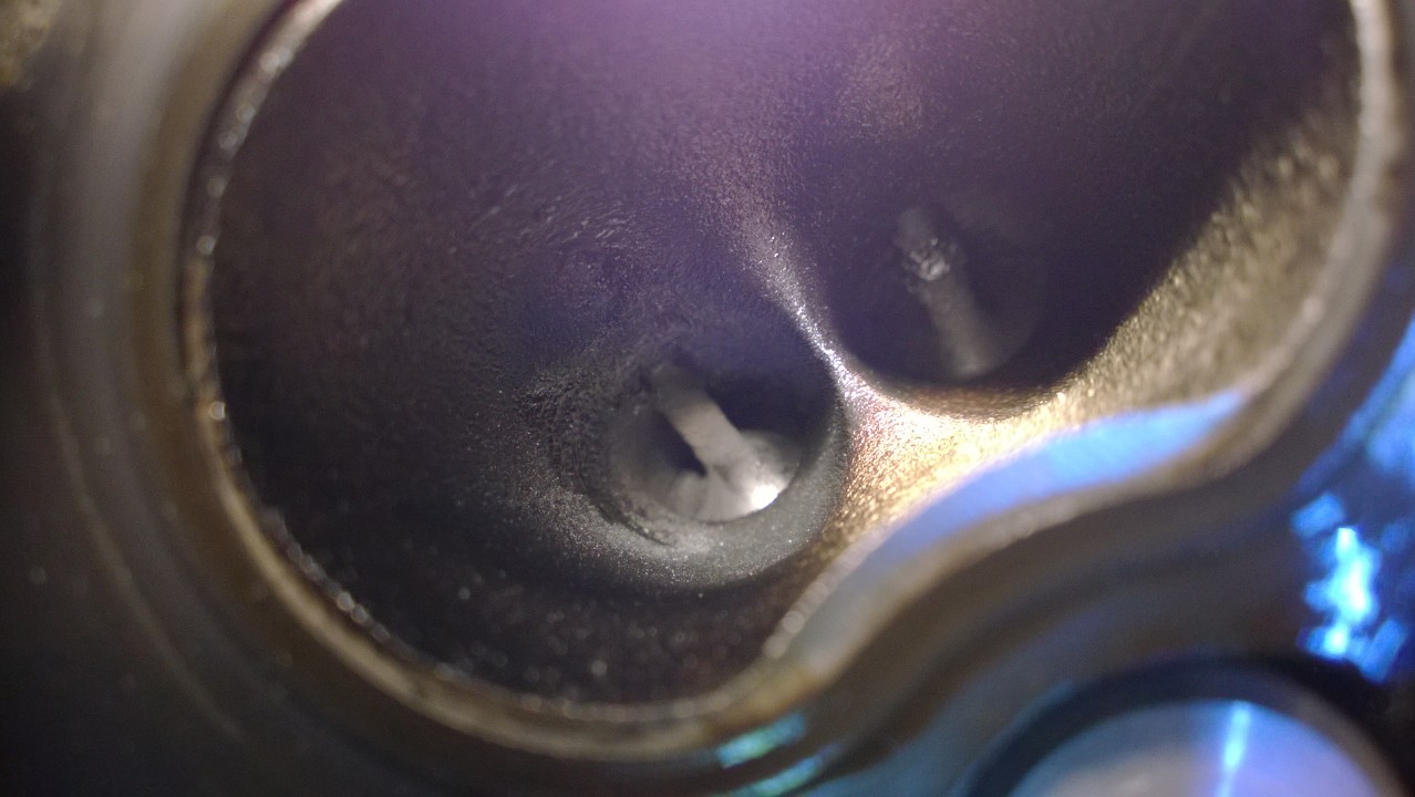

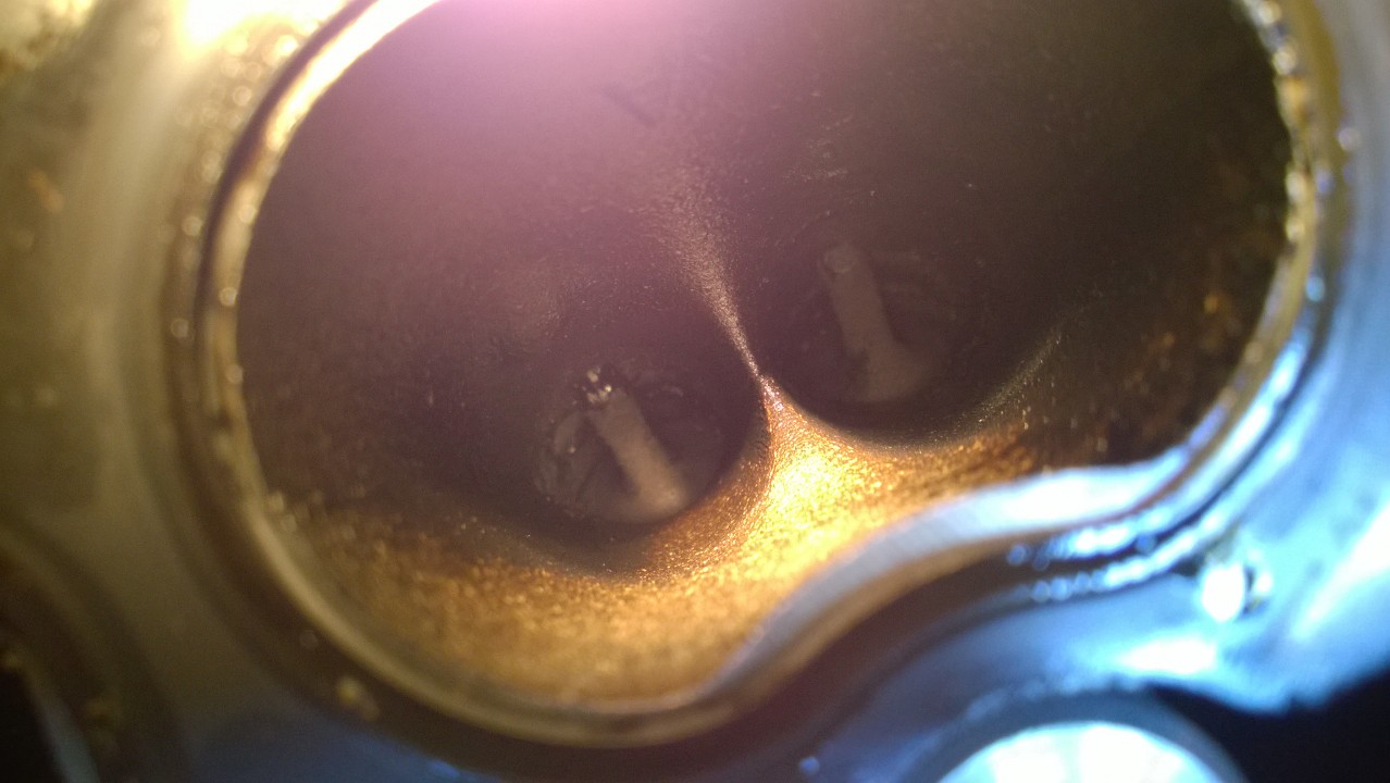

Here are the valves... cylinder 4 doesn't look worse than the others.
Haven't pulled the injectors yet.
Going shopping for walnut media now...

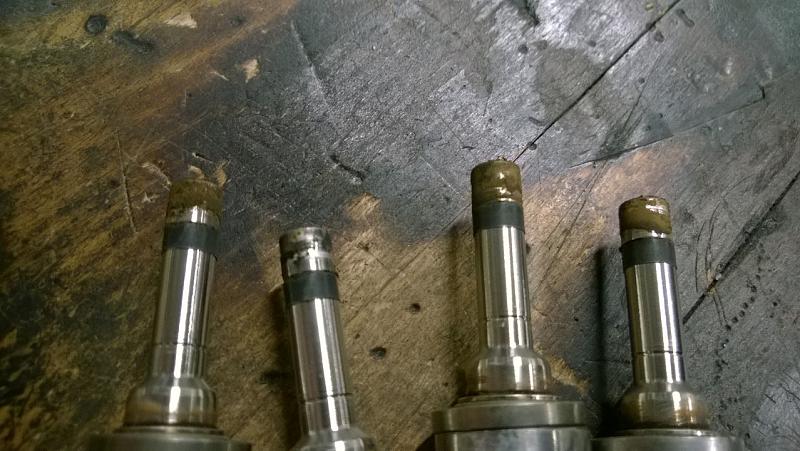

Inkectors 1 2 3 4

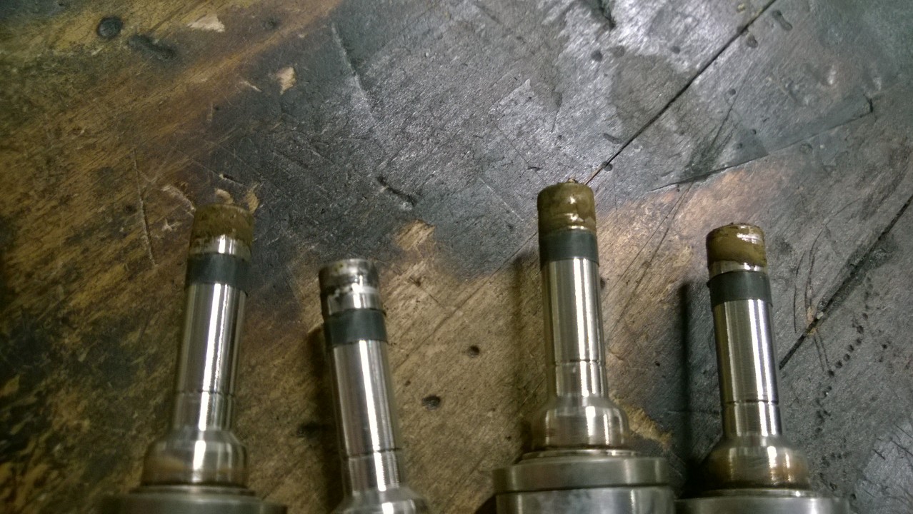

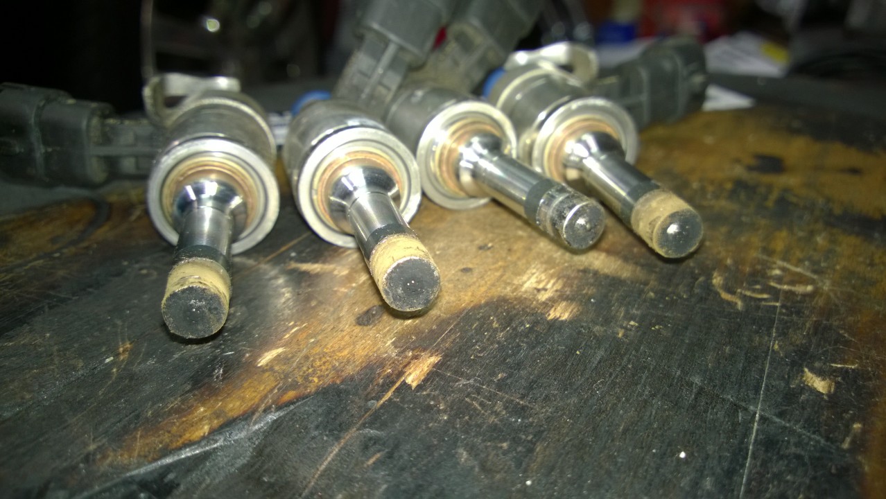

injectors 4 3 2 1
Attached Thumbnails Misfire and turbo issues: yet another thread-inj4321.jpg

All done pretty much. Valves soaked for a few hours and cleaned. Not too bad, but still decided to walnut blast. Not as hard as I thought. Anyway, they look good now.

Replaced all 4 injectors, car runs smooth again
When I pulled the old ones after 2 weeks of use (after cleaning) they were pretty soothy... and found some oil in the intake too
