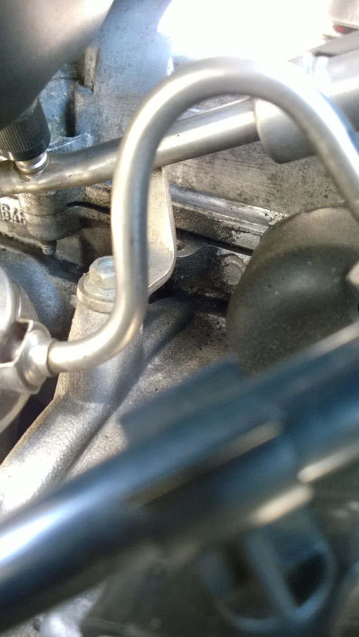

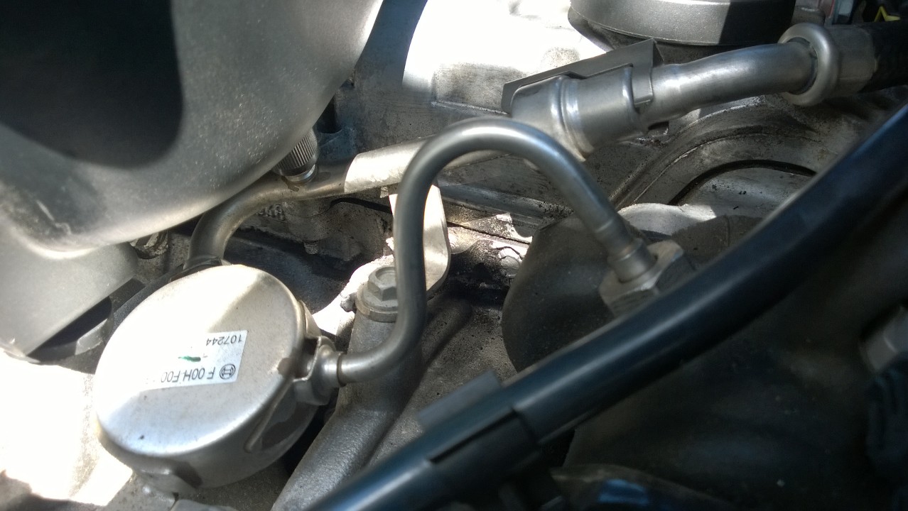

  1. Originally Posted by donbrew
    That looks more like fuel than oil from here. Maybe a fuel leak causing starvation?
Here's a picture from yesterday.... looks more oily...
Attached Thumbnails Misfire and turbo issues: yet another thread-wp_20160720_015.jpg   Misfire and turbo issues: yet another thread-wp_20160720_016.jpg

Looks like you may have an oil leak around the high pressure fuel pump shaft/gasket.
I had small leak there before. The foam cover over the pump soaked up several ounces of oil before in became oversaturated. It them started "oozing" out the excess leaking oil in the same places your pictures show.
Wouldn't hurt to check that foam cover to see if it's soaked in oil.
Good to know, thanks
I'm not familiar with the part but will look into it
Did the leak create any other issues to you? Did you fix it?

That's your HP pump circled in red. Look under it and see if there is oil leaking. You can push in on the bottom of the foam cover to check. If it's been leaking, then that foam may be saturated like mine was.
I never did any repairs to mine. I just removed the foam(GM put it there to deaden the noise of the pump )
In fact, over time, my leak appears to have just about stopped. I get a slight wet area under the pump but never enough to accumulate or drip.
