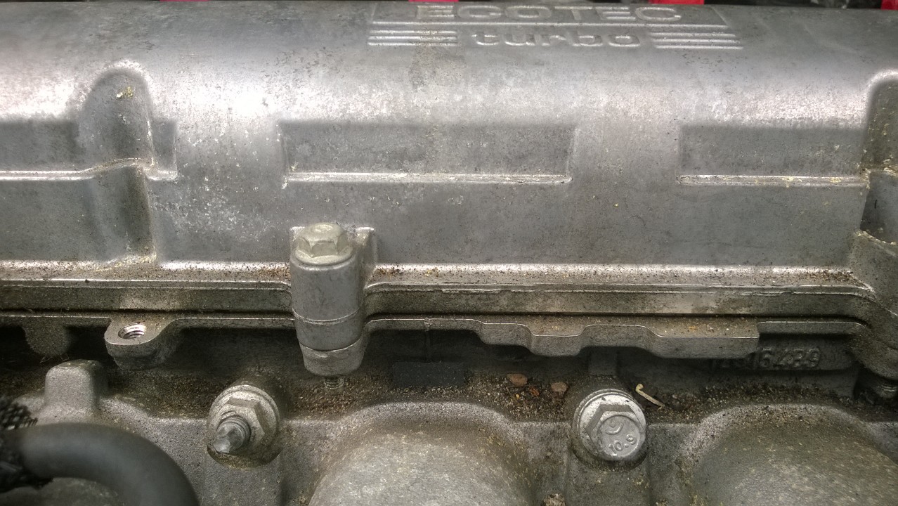

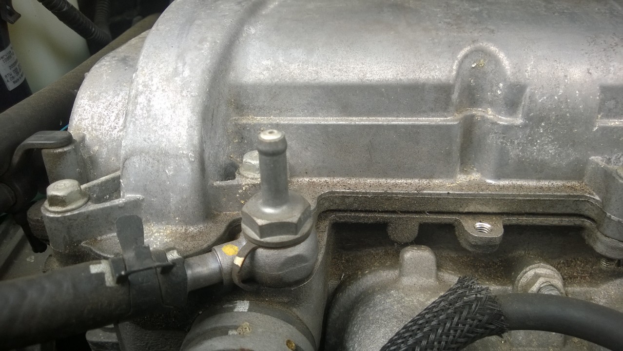

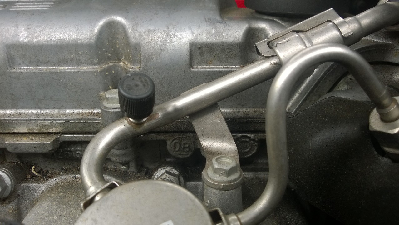

I also just read about misfiring due to cracked injector seals, leaking under boost pressure. Also I heard about valve cover gasket leaking that could cause misfire. I attaché images of my valve cover... I was clean the week before when I regapped the plugs.... not sure why it is so dirty... leak?!?

That looks more like fuel than oil from here. Maybe a fuel leak causing starvation?

Looks like you regularly drive dirt roads? That's a lot of dirt sitting in there, might want to look at your air filter again.
