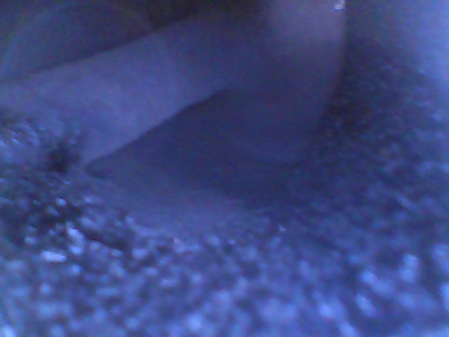

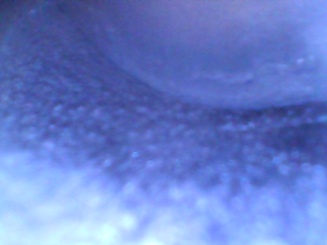

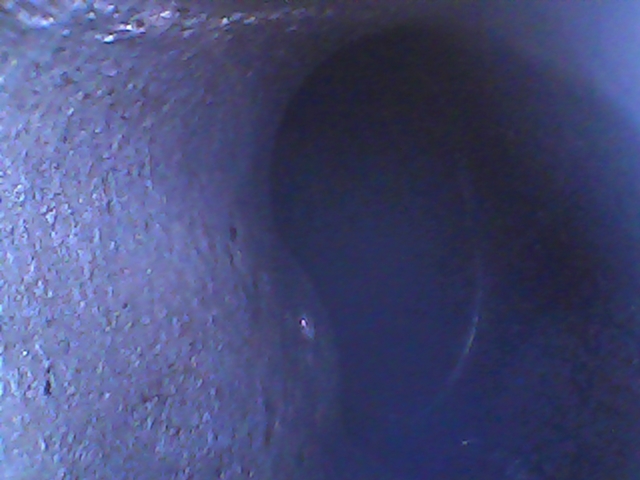

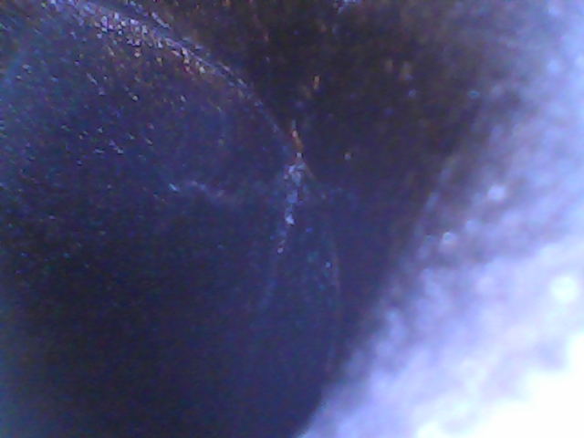

I got another inspection camera and looked ad intake 3 too.. looks the same as 4.
I will post a couple of pictures later

Not the best pictures ever... I visually intake on 3 and 4 really looked the same

Wow, obviously the pictures tell the story of the LNF PCV system and it's effects on coking/sludge.
I'm sure the intake of mine will look the same. And as Dbeluscak suggests, a 5th inject will go a long way in helping reduce that issue. I believe an effective catch can/separator and the addition of the 5th injector will help a lot. Only time will tell.
