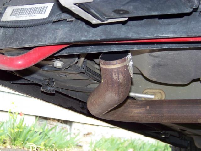

When starting in the back use the reciprocating saw to cut the stocker off about 6" foward of the Sway Bar. There is ample room to get a blade in there, and at this location it is relativly flat with nothing else to worry about cutting through on accident, this still gives you plenty of room to slip the bend over the axel and sway bar when pulling out. Next remove the stock muffler and resonator, and replace with the new segment. you should be able to get the new piece in without touching your cut end. The new set-up only requires 2 hangers instead of the three stock ones. I just doubled up the one closet to the bumper.

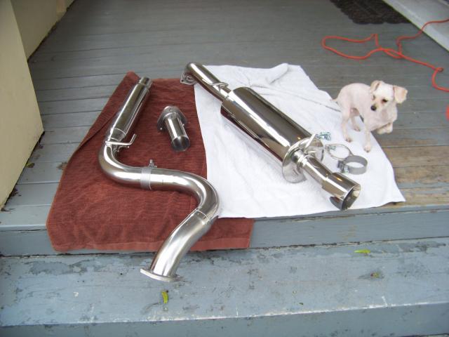

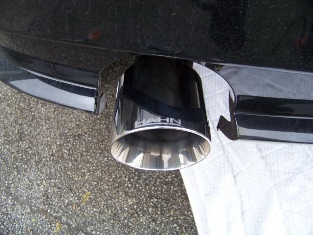

The Product.... Well, I don't work for these guys but I am a fan and have had several of their products in the past and now I'm a proud owner of part #3 for the SS. I still have the DP to purchase, but I will only do that when I can purchase another tune at the same time. Everything I have added so far is playing nice with ECM and the GMTU, and I never saw the need in tunning after each additional part. The fit and finish of the pipe is very nice, and the welds are expertly stacked. The product comes spotless, wrapped in plastic, and encased in expand-a-foam. But the best part is the etched, and fully welded tip. Overall the product is beautiful, and heavy duty. I think it weighs in the neighborhood of 46lbs. The other really cool thing about this design, is the ability to quickly drop out the center section, for when you want to annoy the neighbors, or take it to the track.

Rally, my exhaust tip isn't centered in the bumper cutout either. I'm on Pedders as you know and the weird thing is it rubs slightly at idle when I'm alone in the car (the flange for the rear section rubs lightly right at the axle hump). Now if I have 2-3 people in the car the exhaust DOESN'T rub, ever. 0_o Now Foolmoon, do yourself a favor while driving: turn on Comp. Mode + drop the tranny in "I" gear. Now coast to a stop and listen to the way the exhaust burbles as the tranny downshifts. That's one of my favorite sounds! I hope you enjoy your Hahn exhaust as much as I do!
