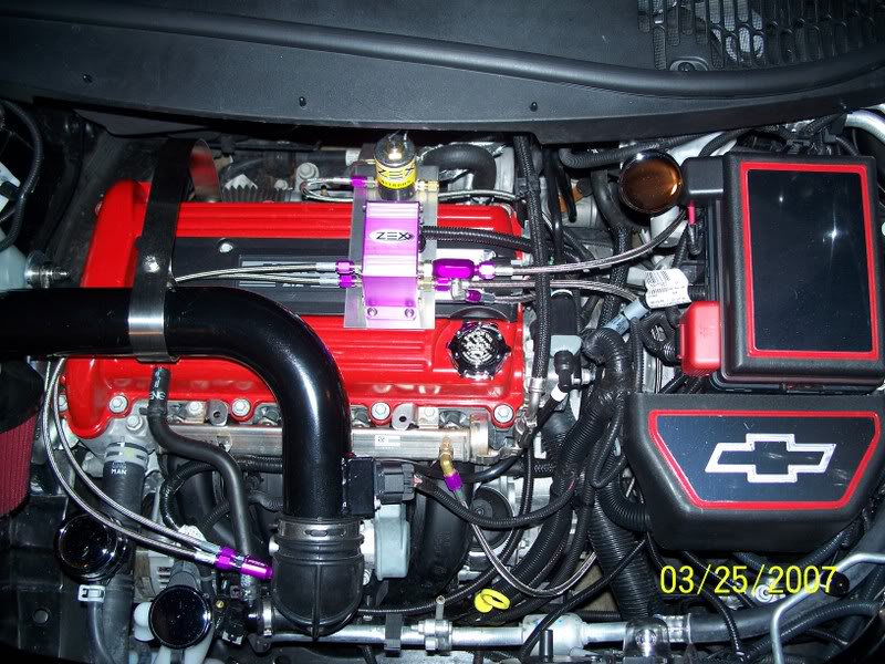

Here is RUDEINC's setup (type nitrous in the search function and you will find many threads):
Old Mar 4, 2011 | 01:12 PM
