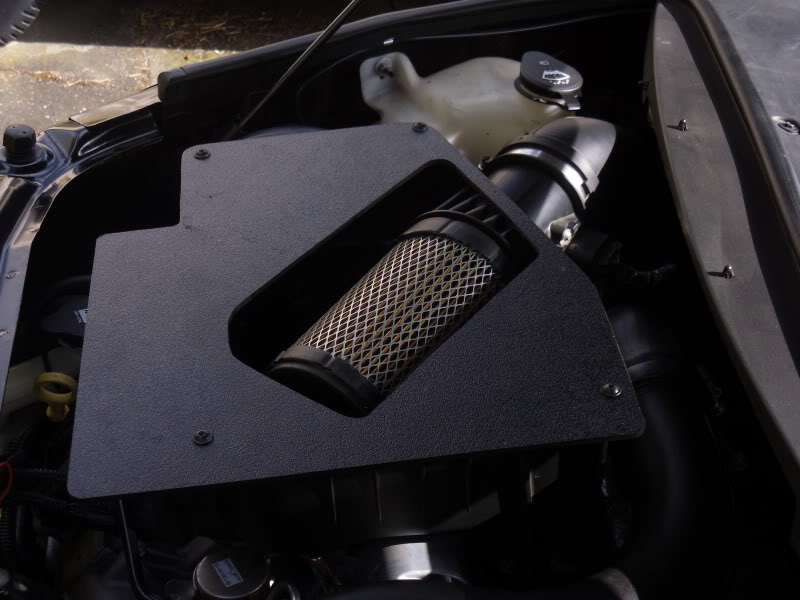

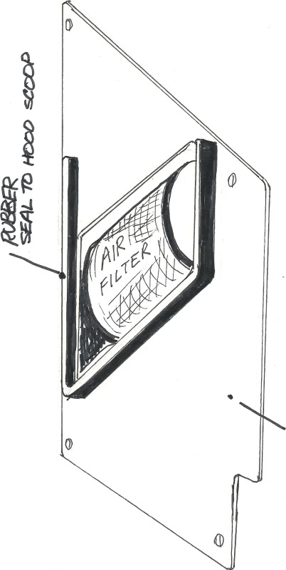

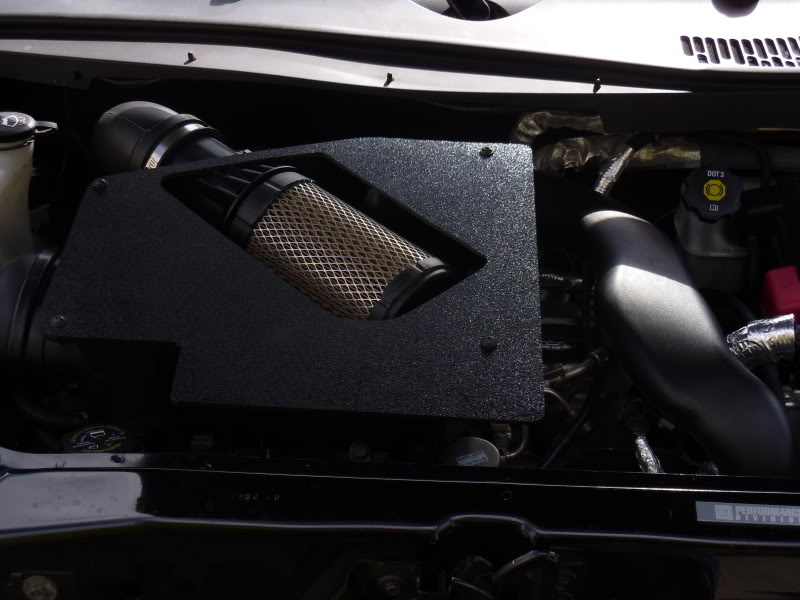

I'm finalizing my new CAI, thats been on the drawing boards for awhile.
The setup I will be using, will be a true CAI, that seals the hood scoop to the new air box lid, and can be quickly changed back to stock[6 bolts] in a matter of mins., for rainy weather, or trips to dealership for oil changes[don't want to get them excited].
Here's what I am doing:
1. Made template for stock air box lid, and plotted air filter location for cutout.
2. Had TAP Plastics cut out new air box lid from 3/16's ABS with cutout for hood scoop mating, that mounts flat.
3. mounted lid and plotted opening for hood scoop cutout.
4. For a better mateing, found my hood scoop needs to be a little wider.So, going to find a wider hood scoop for better fit.
5.Once new scoop is installed and hood cutout to match cutout in new air box lid, will fab a rubber sealing ring to hood, to seal airbox to hood.
Nice thing about this it can be quickly returned to stock, using stock mounting bolts, or converted to a CAI. I used only four bolts for new lid, instead of all six.

If it rains or looks like it's going to: simple put the stock lid back on. Takes only a couple of mins. Out here in Nor-cal, rainy season ends pretty quick, and does'nt rain until around November. Lots of dry time.
The scoop that I'm going with[found one] is same length, one inch higher, and almost twice as wide. New scoop will be wide enough to cover the whole air filter. Nothing off center, in case I do decide to put racing stripes on it later.
P.S. The extra material on the lid at the front is where I'll be mounting the SS logo.
