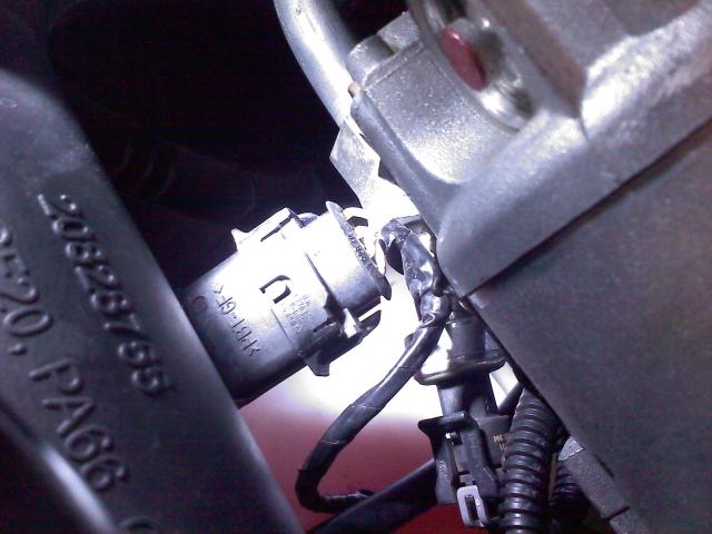

The second sensor is under the front end toward the passenger side between the starter (to the rear) and the A/C compressor (to the front). You'll need a jack or ramps.
Be sure the wires are not touching the A/C tubing:
NOT LIKE THIS
LIKE THIS
