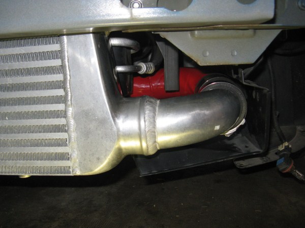

You do not need to remove the bumper install the IC pipe at the IC. Just undo the plastic fender pans. it takes a 10mil and its only 4 screws.
Be real sure to get the T-Bolts, otherwise POP! they need to be tight, but be careful too tight will de-form the pipe
1st pic is hot+cold kit
2nd pic is Inlet
3rd pic is the tight spot, not much knuckle room
4th finished install
total time 30 minutes
PM if you have some questions
PS the cold-side is a *****, and requires moving the radiator foward about an 1.5" (made brackets). On the plus side the T-map no longer touches anything!
