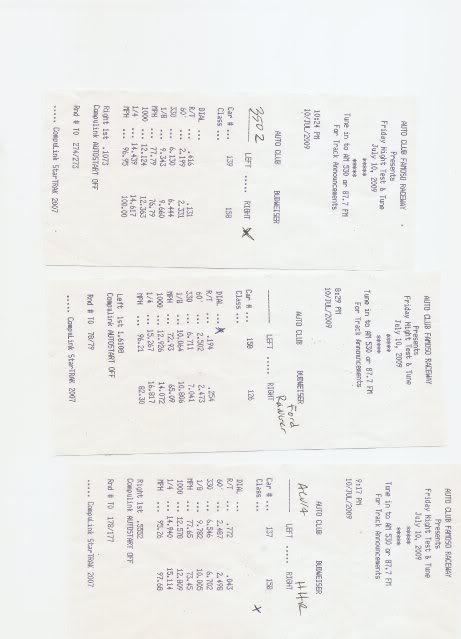

Old Jul 13, 2009 | 04:00 PM
skimike's Avatar
Joined: 03-13-2009
Posts: 90
From: bakersfield
Size:  33.3 KB Name:  HPIM1976.jpg
