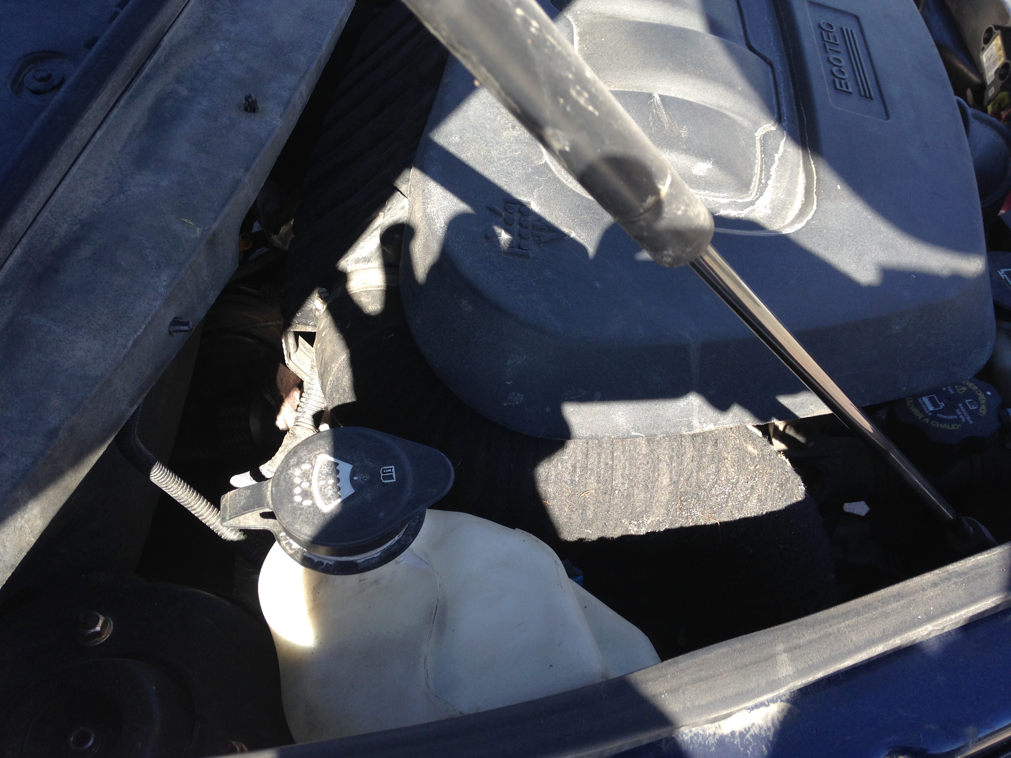

My pictures is to illustrate that an extra fresh air hose can be added and that the filter box should be closed

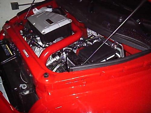

This system picks up outside air just like my home made system just over top of the drivers side of the rad, for $350.00!

Here's where the air boxes are similar, they both sit on top of the valve /cam cover, they both have room to add a hose to take fresh air into the air filter box
this is a picture from the driver's side
