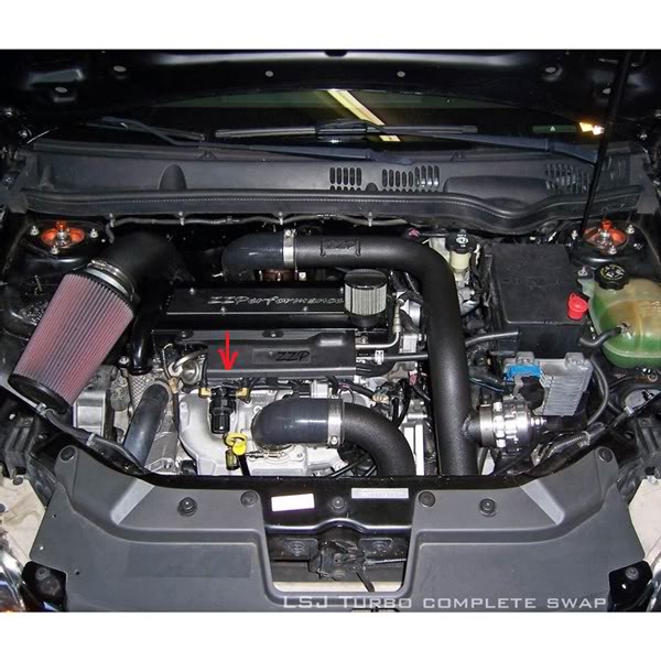

Option 3: This determines the boost control of the kit, 375-400whp tune is a ZZP pcm with a manual boost controller, that turns the boost up or down with a knob and is (usually) mounted under the hood. This option requires you to either send in your PCM core first(preferred) or pay the refundable core charge.
The selectable boost control option uses boost controls that uses the factory Traction control button that can change the boost in turn changing the power of the car. The low setting will be 18-19psi and the high boost setting will be 24-25psi.
^this is a completely separate option. the hi-lo boost switch is something WAY different than our MBC. as long as your over/under boost tables are adjusted broad enough, you will not run in to issues.
(just an FYI, i do not sell the MBC seperately on my site, you wont find a product description page for it, it's only included with kits...maybe that is where the confusion is coming from)

MBC seems like bad idea in my book unless the tables are adjusted enough be safely used?? I can just see someone buying this kit and turning knob with no knowledge and then blaming zzp for bad kit..... Steve I'm sure you know where I'm going with this input....
I know most turbo kits avoid mbc for this reason
the trans is a 4t65E (Grand Prix GTP transmission) with custom adapter plates, and lots of internal goodies (same trans that is in our mid 8 second grand prix) it is indestructable :)
when you lower the boost on the MBC, the maf makes up for the difference pretty well, and adjust the fuel accordingly.
we dont sell the MBC as a kit, it only comes with our turbo kits, which come with a tune...you can set max boost in the PCM so it closes the throttle (to prevent people from cranking it up to the stars and scattering engines on the pavement)
