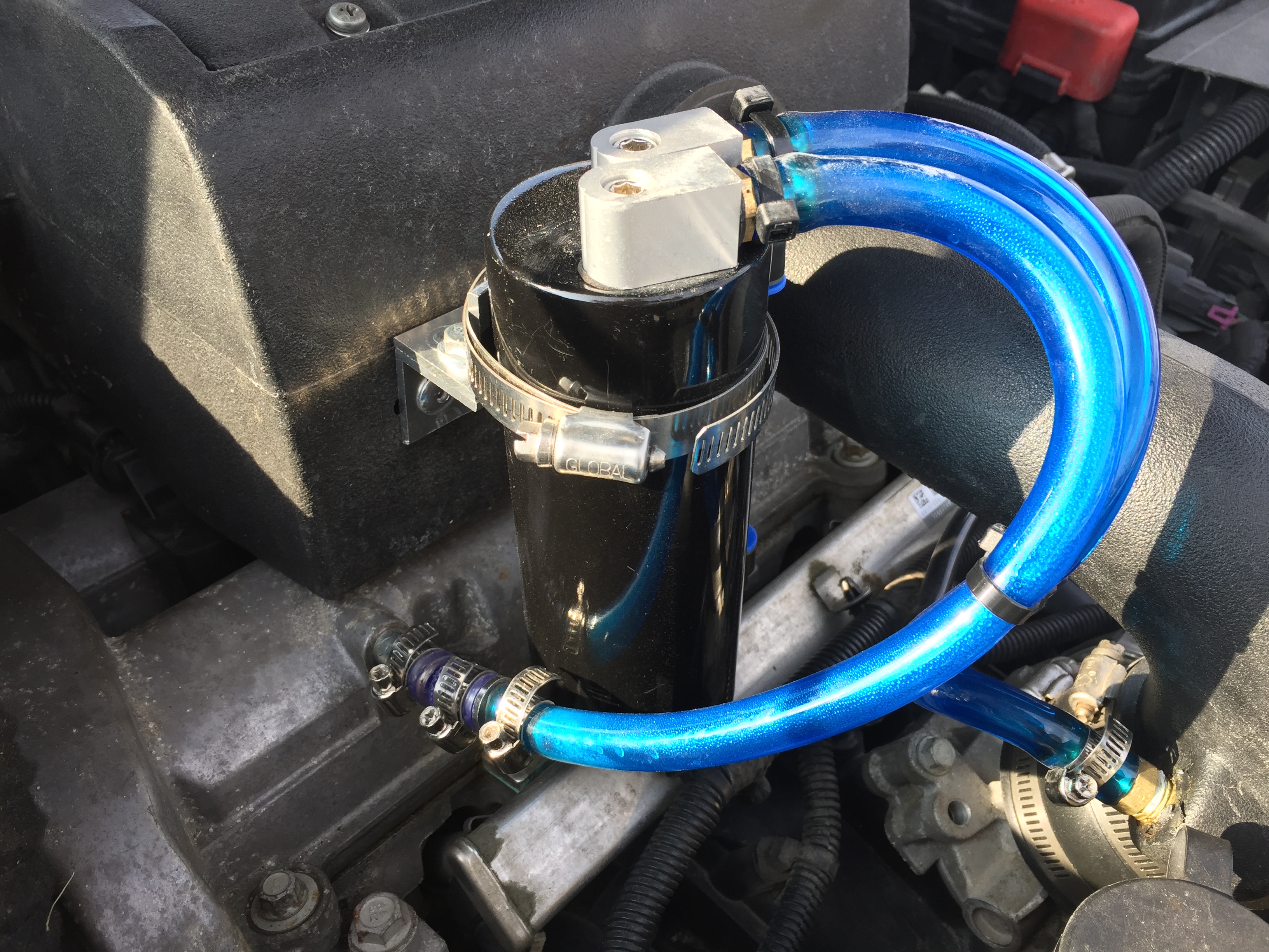

Well that didn't take long, in my OCD mind, I can't wait for things to happen, so I took a highway run from home up to Lake Ontario, then along another highway 45 miles and then back, all at the exact speed limit, really officer, so about 110 miles total , and finally squint hard at the dirty line and there is so condensation getting sucked up to the tank.

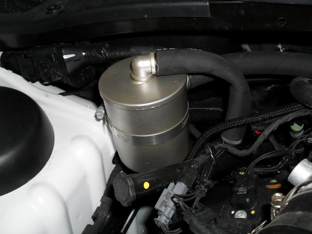

Here's a home made oil separator I made for my 2013 Challenger when I had it. It was a 3.6, went from the same locations you have. I know doesn't show you a lot.
This can was built out of a primary fuel filter for a diesel engine, but the top was cut off so I could put a membrane inside it and then I epoxied a lid on top. And it did collect oil. I only had 6K on the car when I turned it in for my SS.
The can is not mounted low, in fact it was on the strut tower above the two ports it was connected to.
Your can will work. It just needs an element inside it.

I stated earlier, I want to keep it simple, I'm not suggesting I change anything, therefore not over thinking the setup. I don't want a pvc system like the 2.0 turbo SS has, I just want to catch any oil or condensation in the separator tank and keep that slop out of my throttle body. It's working just fine as I posted in #41.
I did this as an experiment in the same vein I have built Oldblue, with gently used or inexpensive parts.

Took a 175 mile cruise in the countryside yesterday, still no dreaded codes, the throttle body is clean and there's no oiley residue on the throttle blade or out the exhaust tip!
Old Feb 25, 2017 | 07:07 PM
  #49
Posts: 40,083
Another 200 mile trip, same as last post! So no oil sucked into throttle body! No CEL light. I'll keep you posted!
Old Apr 1, 2017 | 01:27 PM
  #50
Posts: 40,083
And so it's 2 months later, several long drives, still no oil being sucked into the TB !!
That was the goal to keep the intake clean! I've noticed improvements in fuel mileage, much better throttle response, and my stainless steel exhaust tip is much prettier! No black carbon build up!
