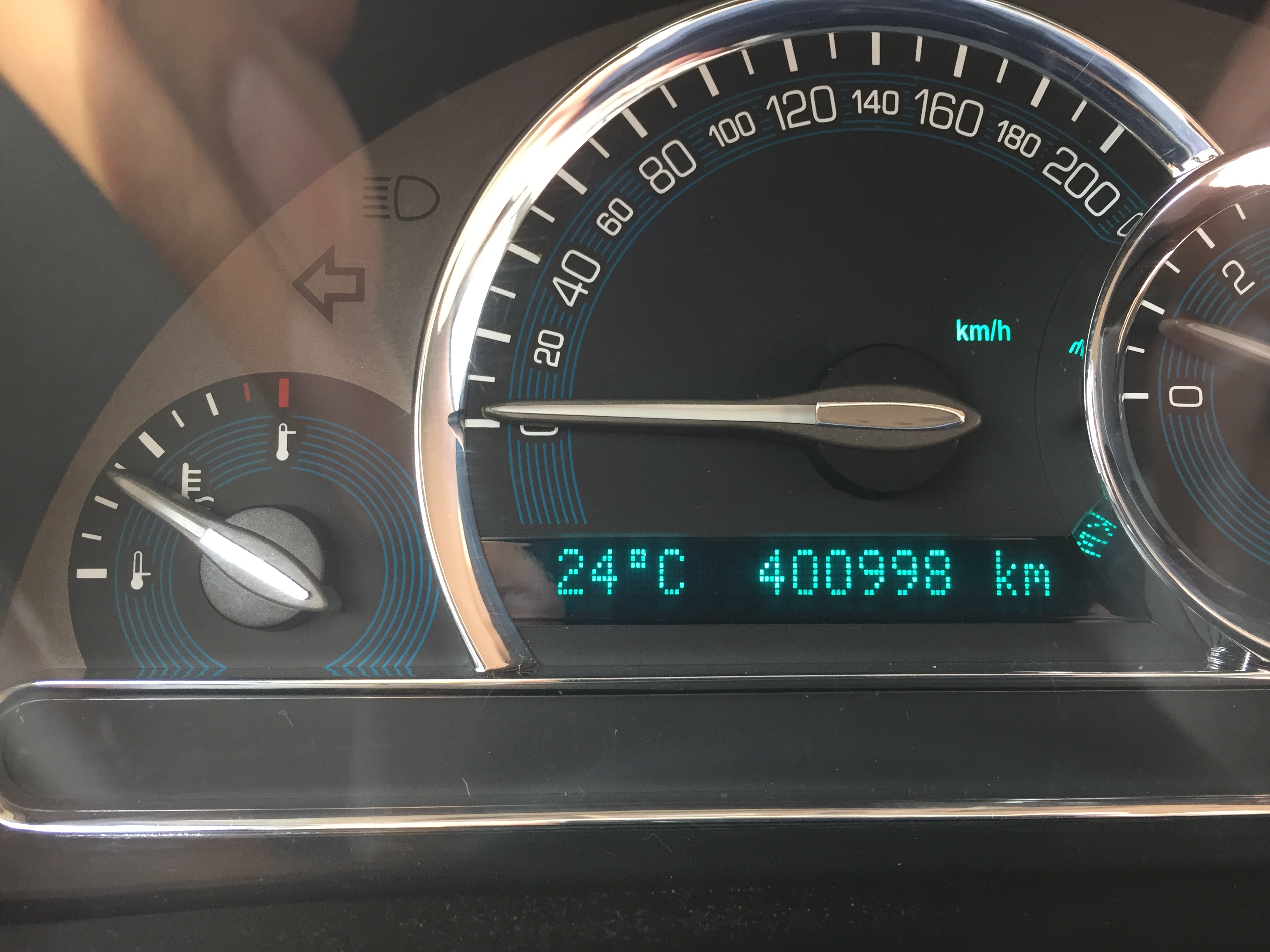

I just got a text from your engine. It says it will do it's durndest to get to 500,000 klms(and beyond!!)
Old Oct 23, 2017 | 08:09 AM
  #65
Posts: 40,083
Almost there!
Attached Thumbnails 2.2 Oil catch can, more of cleaning up then performance!-5cc45ac4-2ec9-42e6-879d-35dd57cd851d.jpeg
