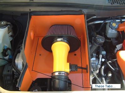

well i was told by Sam that the tabs need to go under and that would have helped more and gave it better alignment. needless to say, it happened on mine so i was just telling people what to look for.
the new grommets i put in seated allot better and more firmly and lowered it and for $2 a worthy and inexpensive fix.

Since your airaid is on its way to me, i was wondering what tabs you are talking about. i pulled up the install sheet on airaid's site and printed it out but it says nothing about tabs. if you could post and possibly email me pics of these tabs that would kindly be appreciated. And a big thank you again for everything CJ

a post would be great for er'body

your box is already put together so you dont have to do anything but remove ur MAF housing off ur tube, put it on the black tube, bolt the tube to the housing, then put the MAF plug in thru the grommet, then hook up the black hose to the wheel well and then push the box onto the studs on back and you are done
smiles
i will see if i can find a pic w them showing. on hvrods pic, you can see the overlap on the inside of the box instead of under and that is what he calls the tabs

I think cj was referring to the lines running across the sides. The whole bottom plate should be sitting on those "tabs" and not below them.
