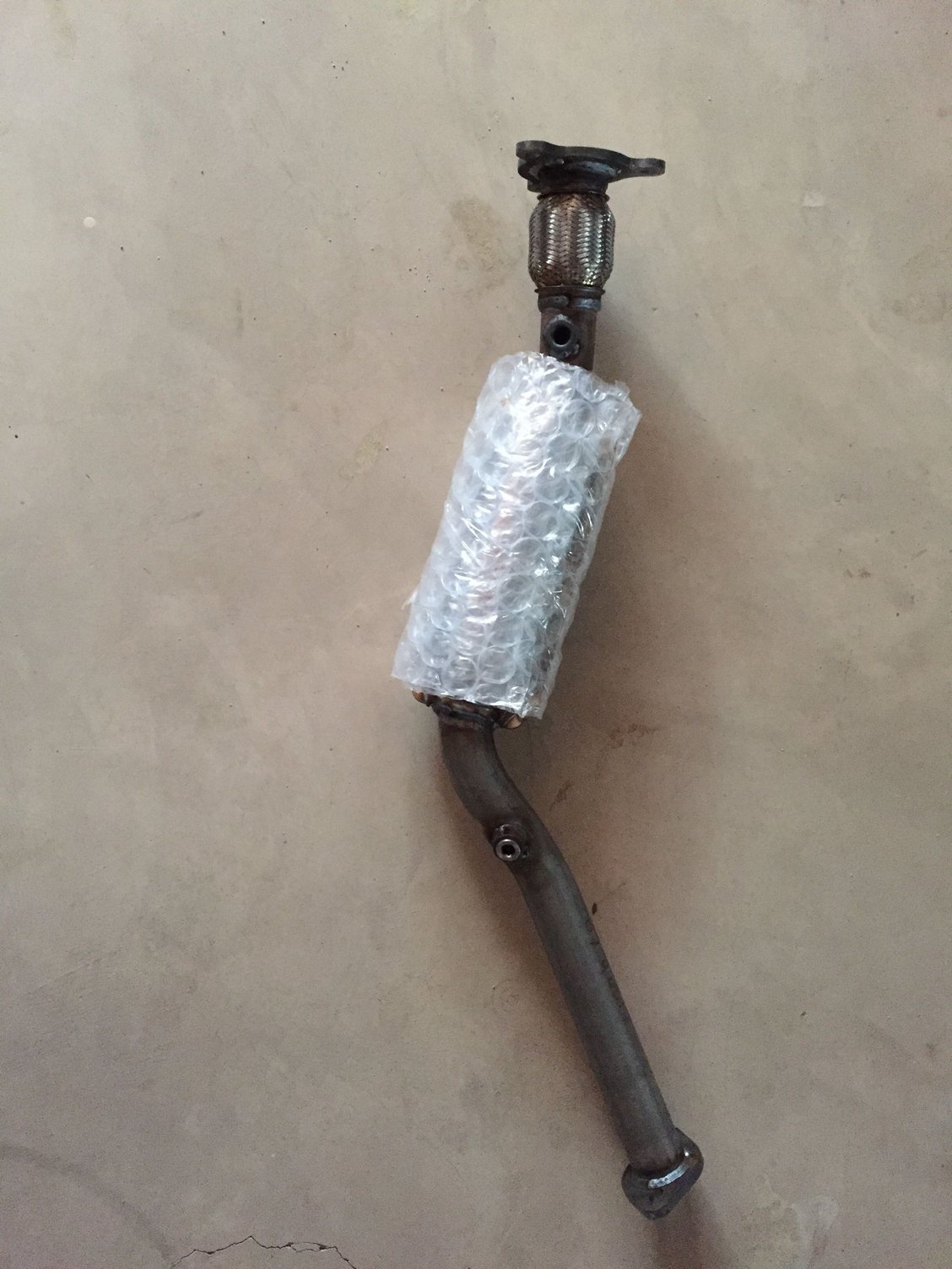

I’ve had it for two years now, had to get up close with it last Monday to swap out the fuel lines, it not rusty or crusty, however, next time I’m going to a custom bent SS system, we just had the Sunfire GT done and it’s awesome, just $60.00 more then the Walker system, for me it was the 2inch catalytic converter down pipe that opened up the breathing, no pinched bends all mandrel bent tube
Smooth bends
Mandrel bent curves
OEM 1 3/4 pipe , kinked bends
