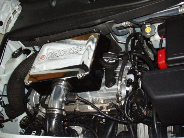

Originally Posted by briand
I agree. Add some sort of insulation to the inside of the box. Also, place the C.A.R.B. sticker on the inside of the box.
briand-
My GMPP CAI landed here slightly pre-owned.. I did re-locate the C.A.R.B. sticker to the underside of the lid. Out of sight, but still easy to show if there was ever a need to..
Insulation:
Now after studying my box, I'm gonna insulate the exterior underside 12"x 12" floor.... IMO better to repel radiant heat before it heatsoaks the steel floor, plus the DryFlow* filter is on the floor, it's that big.. I am gonna use Thermo-Tec* self-adhesive Heat Barrier. I will do the inside (but) 'side walls' only..That is mainly so the insulation won't be readibly visable...
Silver11-
I don't think you would have a problem adding one on to your 2011 2.4L, your Local Dealer should be able to confirm this for you..
"Also is there a wrap or something for the wooly sock to keep the air cooler?"
Yes many places have insulation wraps for the wooly worm.. Just google it,
Jegs, Summit & many others have wraps & some are lace up kits..
