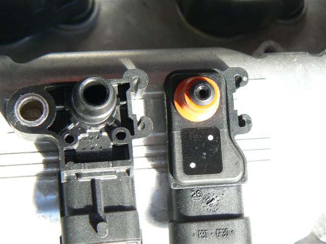

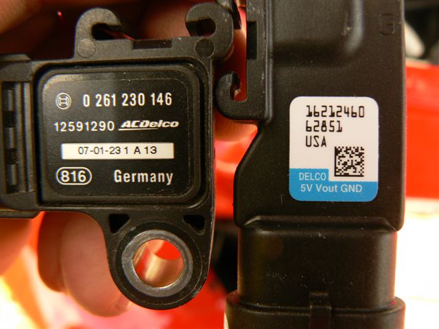

Here`s a pic of the MAP sensors from my 07 2.2 and a 06 2.4 the bigger one on the left is from my 2.2.When I put on the 2.4 intake I stayed with the 2.2 MAP sensor and just drilled the hole a bit larger to fit the 2.2
When I saw how much larger the hole was on the 2.2 sensor I thought it was best to stay with the stock one.

i dont think thats the sensor he is referring to. he was talking about the mas or maf. it measures incoming air velocity temperature and a few other things. the map records data on the manifold. only time you would need to change the map would be to turbo charge as the stock map can only see up to one bar (14.7 psi or pressure at sea level)
