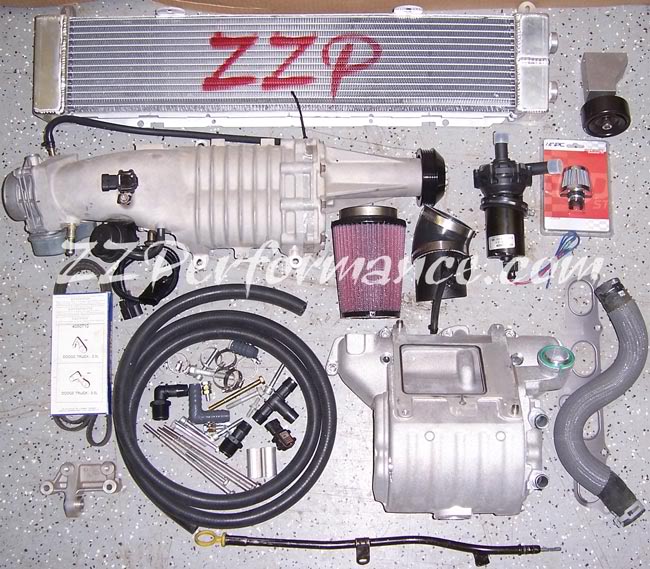

Old Feb 21, 2012 | 09:13 AM
American & Proud's Avatar
Rest In Peace
Joined: 06-13-2010
Posts: 2,301
From: IL.
As long as you got it out, might as well just go for it.
