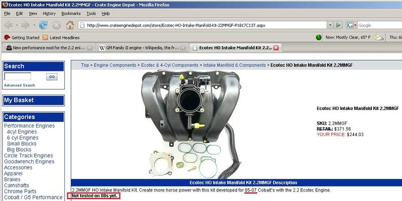

I base that off all of the advertising for the 2.4 intake manifold kits for the 2.2, they state that it will work for the 05-07 2.2 Cobalts, but that it has not been tested on the 08 2.2 Cobalt due to a "different intake design". Granted this is for the Cobalt not the HHR but...

I was reading through the GMPP racing mods manual and it said there was a mid-year change that added a camshaft sensor, making some parts incompatible.

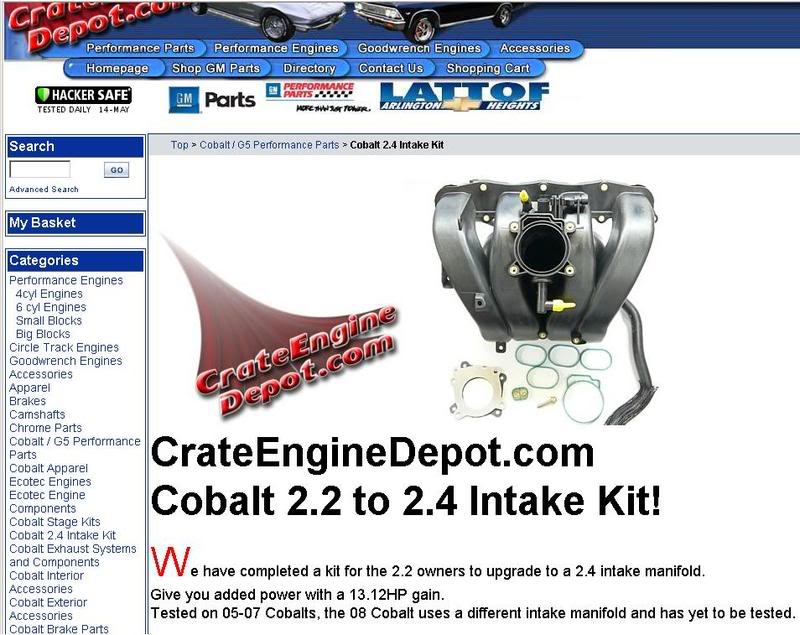

CrateEngineDepot.com
Cobalt 2.2 to 2.4 Intake Kit!
We have completed a kit for the 2.2 owners to upgrade to a 2.4 intake manifold.
Give you added power with a 13.12HP gain.
Tested on 05-07 Cobalts, the 08 Cobalt uses a different intake manifold and has yet to be tested.
Dyno tests:
GM's Stock 2.2 Intake manifold HP Best: 138.61 @ 5500
CED's Kit 2.4 Kit Intake manifold HP Best: 151.73 @ 6300
Gain: 13.12HP
GM's Stock 2.2 Intake manifold TQ Best: 140.00 @ 4400
CED's Kit 2.4 Kit Intake manifold TQ Best: 142.12 @ 4900
Gain: 2.12TQ
Dyno Video Link: http://videos.streetfire.net/video/2...77000761d5.htm
Test vehicle stats: 2007 Cobalt 2.2 5sp MT
Mods List:
GMPP Intake Pipe
2.4 Intake Manifold
GMPP Sport Catback
Prothane MotorMounts
Eibach Prokit
SS/SC Front Sway Bar
Progress Rear Sway Bar
Sumitomo HTR 225/50/15 Tires
Testimonials:
I am happy with the performance, and how the car reacts. I feel the car is more responsive and the power is more linear. It doesn’t seem to pull hard then start to wheeze like it did.
Note: as seen in charts minor torque loss at lower RPMs.
Look at all the mods. its only 151hp with intake, exhaust, and intake mani... so the manifold it self added 13 hp yeah thats not bad for the price, but not that tuning is available... 2.2 guys should upgrade to the 2.4 throttle body too
