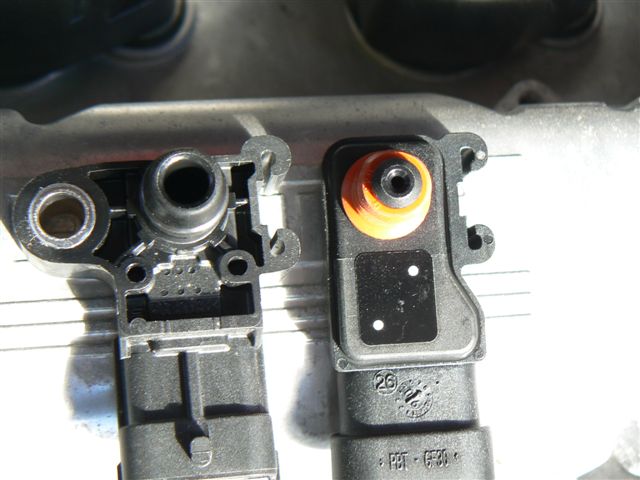

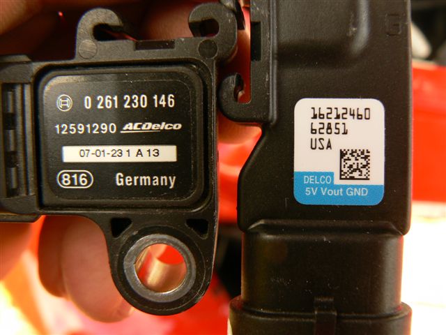

The main problem is one of the sensors is different. I will try to find out exactly what sensor it is and try to find one that will work with the 2008 harness and 2007 intake.
I had the same problem I used a 06 2.4 intake for my 07 2.2 the stock sensor from the 06 was smaller than the 07.All I had to do was drill out the hole the same size as my 07 sensor.
The only other thing different was my sensor had a 10 mm. bolt that the 06 intake did not have but it still went on nice and tight.

Thats it!
Thats it! That is the little POS that gave me all of the problems!
What sensor is that?

That's the MAP (Manifold Absolute Pressure) sensor. If you can figure out the wiring (5V, signal and ground) you could splice the harness.

Joe, So you are pretty sure they are the same?
At this point I would rather splice the harness than ream the hole in the intake because I do not want to take off the intake again.
As a temporary fix I just put a short vacuum hose on a nipple in the existing hole as an adaptor so I could use the stock sensor.
It works and I would probably never have a problem with it but it is not right and I do not like it. I would prefer a cleaner more proffesional looking installation on that sensor.
You only have to pull off the fuel rail to get to the sensor and drill it out.

How hard is it to remove fuel rail?
What size did you ream it to?
I do not like the idea of reaming the hole because I do not want anything to go down into my engine.
Fuel rail is easy if you use a new sharp drill bit and go slow the plastic should stay in one piece.You just need to mic the sensor and then use a bit a fraction larger.The hole on mine is a 2 step so I had to drill out the smaller bottom one 1st then the bigger one last.
Just take a look at your old intake first to see what you need to do too your new one.The best bet is take your old one and just find the drill bits that fit tight in the holes.You are only drilling plastic if you get a tiny piece that falls in the intake and gets sucked in the engine it will just burn it.Or you could take off the throttle body and catch anything that might fall in.
