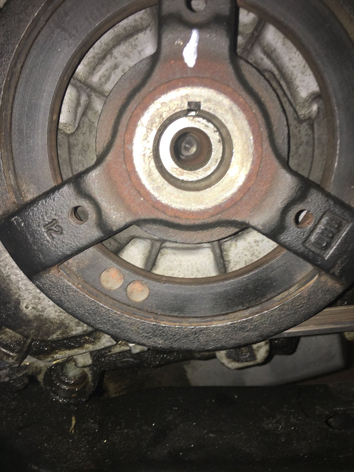

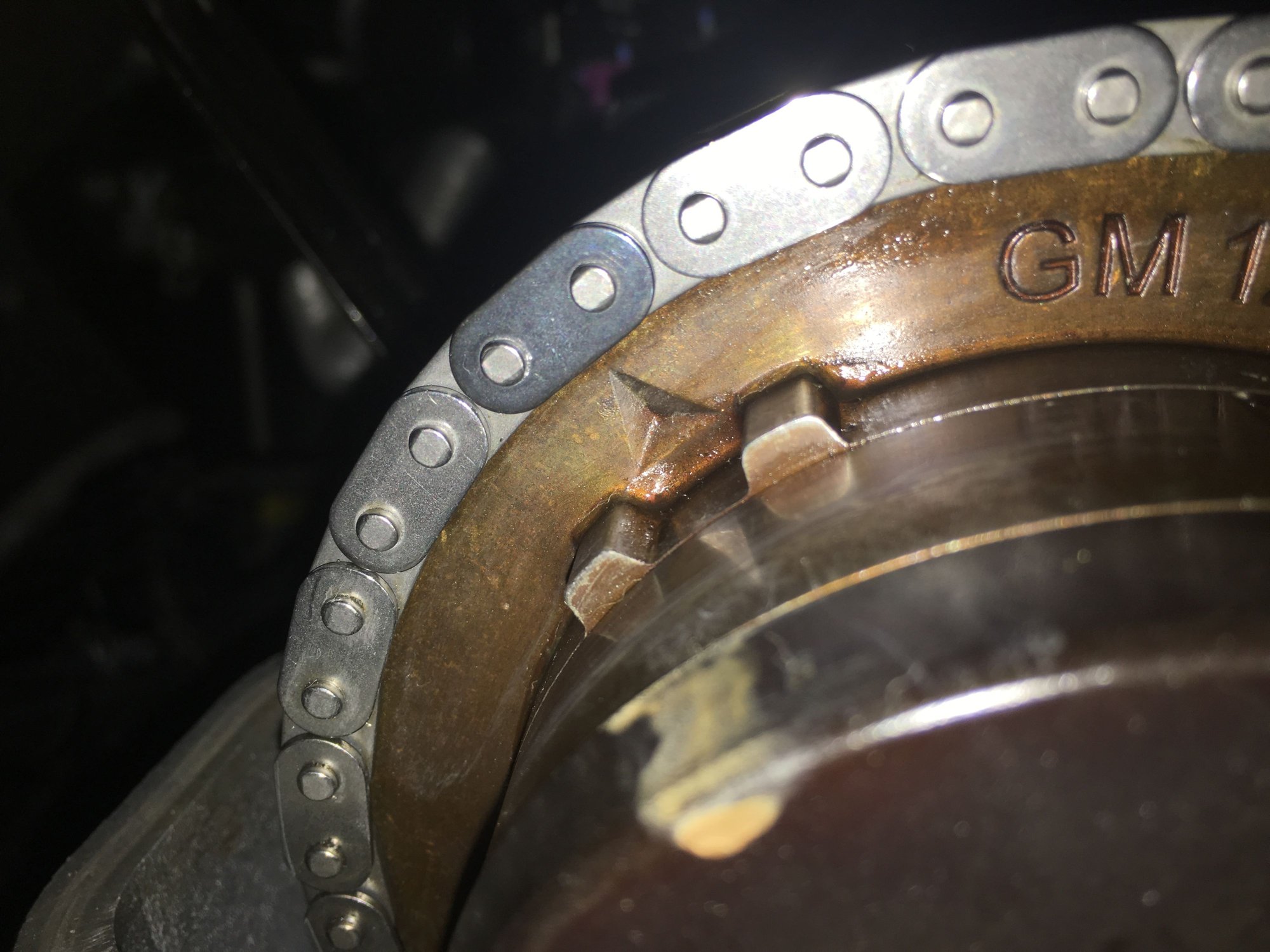

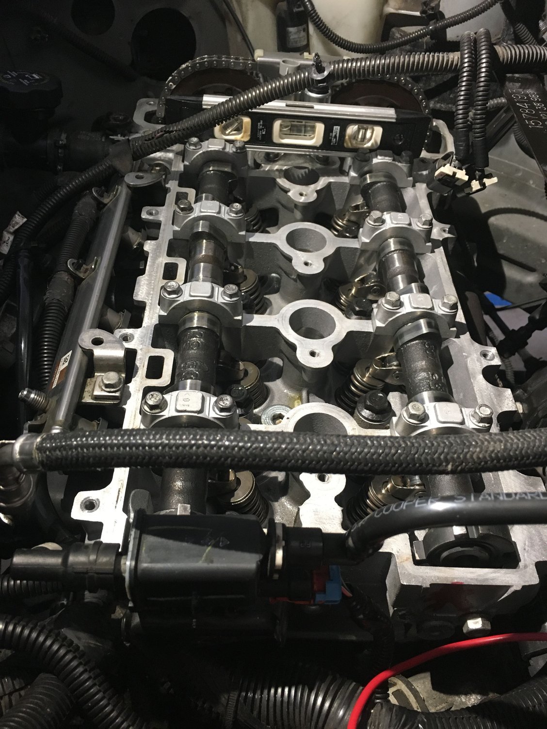

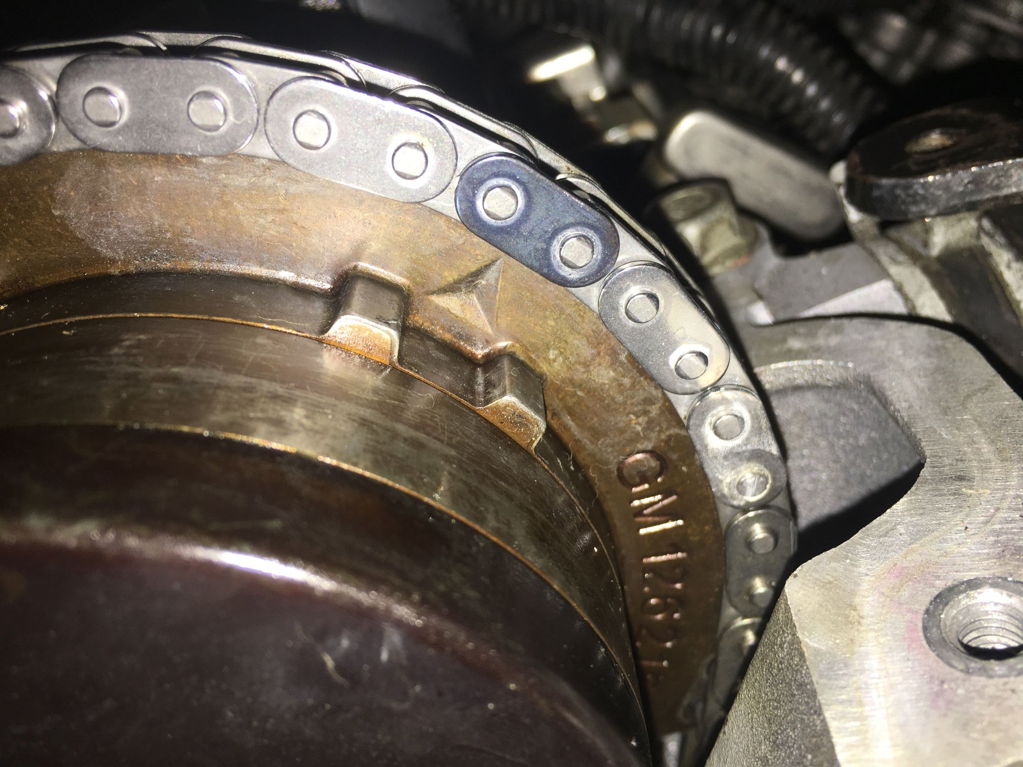

Here's the pictures I took just now let me know if you can see them please
Old Oct 6, 2019 | 11:31 AM
  #59
Cat Man HHR's Avatar
Joined: 08-03-2010
Posts: 3,564
From: Lake Ronkonkoma, N.Y.
Yes we can see the pictures.
You show the marks for the cams.
Where is the picture of the chain on the crank sprocket ?
You show the damper is installed to the key on the crankshaft.
Why the pictures of the cams ?

I was worried I never done this before I'm sorry I couldn't get a picture with both cams in it but its impossible with it in the engine.I hope this helps you guys
