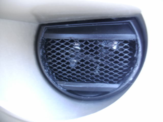

Picture of my CJ inspired intake,with the filter behind the headlight and drawing cold air from the cutout fog light cover.
