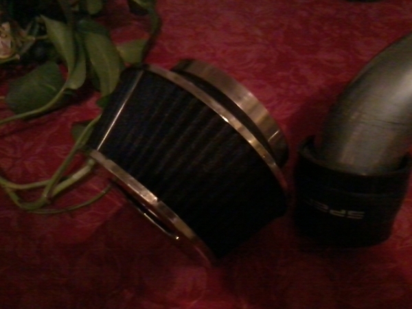

Mine got smashed all up to hell too
Originally Posted by phcoy
Thanks for all your input. I will definately try a replacement filter.
The exact same thing you described. The shorty filter helped alot.

Your picture has the Spectre filter (fits 3" tube) and the 3"-2.5" Spectre rubber adapter I looked at, at AutoZone. The adapter 2.5" end should work on the 2.5" CGS tube. The only problem I have is what kind of short piece of 3" tubing to connect the 3" end of the adapter to the 3" intake opening in the Spectre filter. Possibly a short piece of PVC pipe? Any suggestions?

LMFAO I had to read that like 4 times. Everything on mine came with the filter and that adapter. It all fits.
