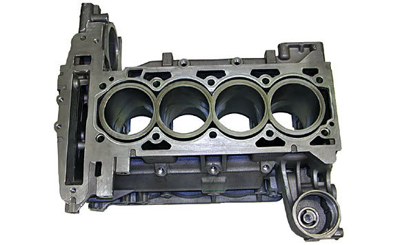

Hello, I can't solve my problem alone, so im asking for some support.
I have 2008 Chevy HHR 2,4 ecotec (i think it LE5 l4 A24XE) and probably i have damaged engine block.
My car is loosing coolant. Already ive changed head gasket. I checked cooling system, there's no leak outside the car. Theres no signs of oil in coolant. Spark plugs was checked, non of those was "washed" (extra clean).
I think coolant is not mixing with oil (theres no butter under the cap and the color of oil is ok). But i think coolnat "enters" directly to the exhaust or its burned partially in engine (dunno). He must go somewhere (coolant). I dont see more options. so i consider replaceing engine block. My question is, were those engines was installed in other GM cars more available in europe? (Opel? chevy captiva?) Availability of parts for HHR in Poland is almost a miracle. I am almost powerless. I rly like my car and i want to do what i can to fix him. To be sure i give you my VIN number 3GNDA53P08S610822 (if i mess sth pls correct me). Thank you in advance for help. Sorry for bother folks.
If You have more ideas what else can be check, please let me know.
