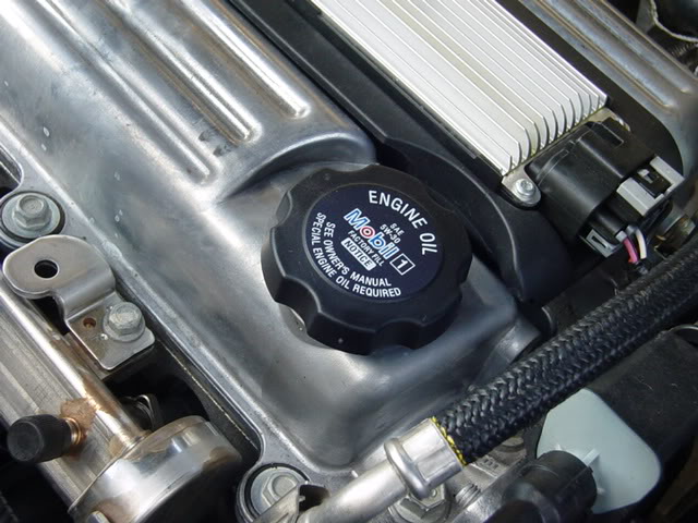

The cap I used was a cap for LS1, LS2, LS4, LS6 and LS7 engines Corvette Camaro, Firebird, GTO and 5.3L engines in the '06 Impala SS, '06 Monte Carlo SS and '05-06 Grand Prix GXP. GM part number 12555685. Key is that it's the quarter turn style cap. Found it and the info on LS motors on ebay. 2.2 and 2.4 use the same cap.
