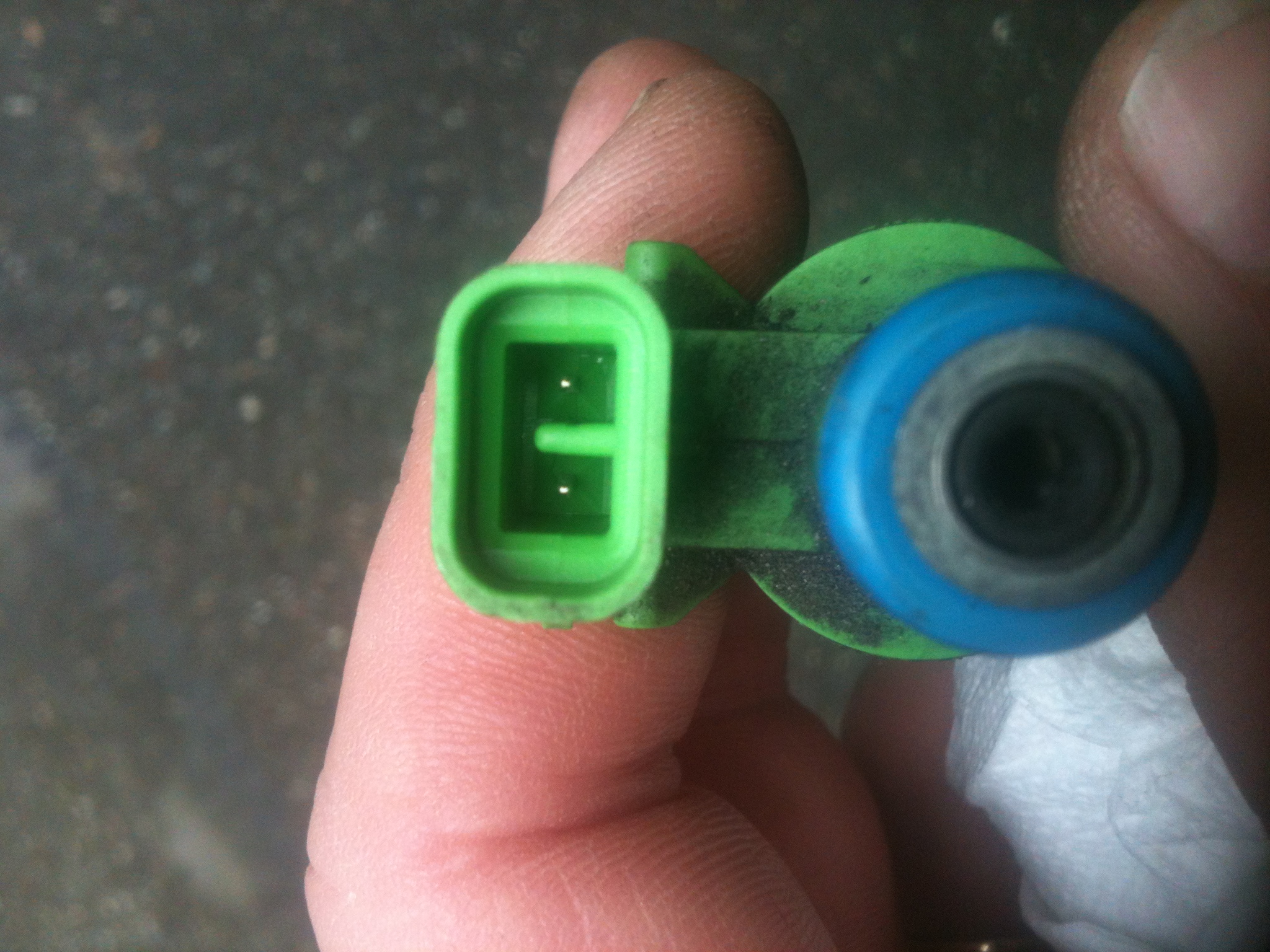

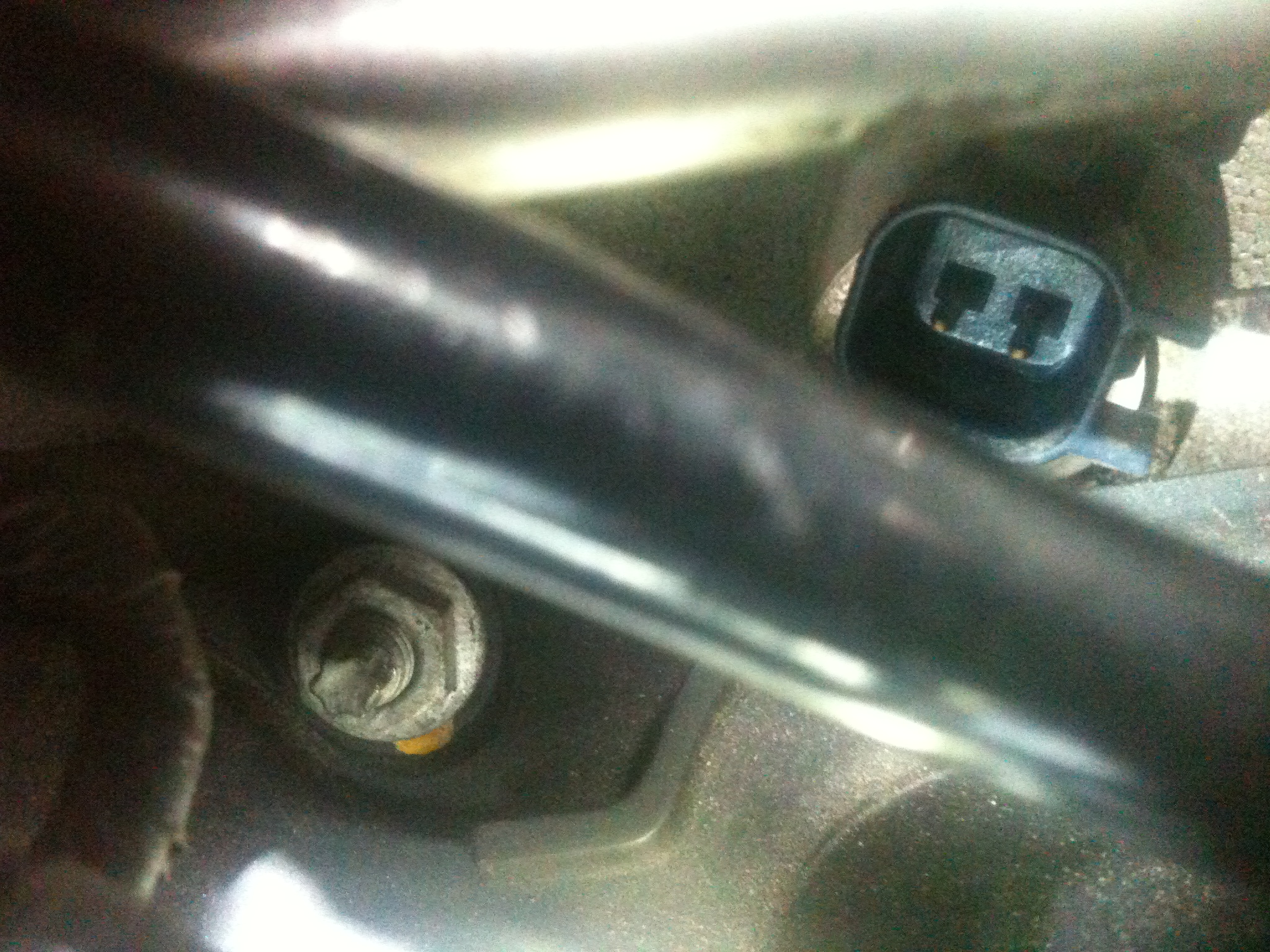

pics of stock injector connector and one like I used.

If you use EV6 long style injectors you are fine. That is what you get in the ZZP kit. They work with stock harness and rail. You should not have an issue.
