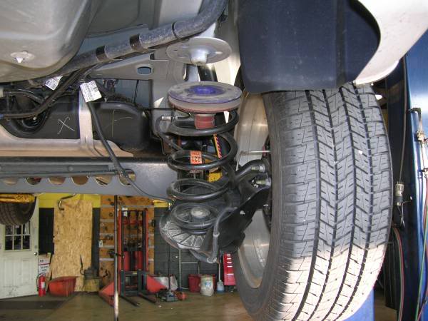

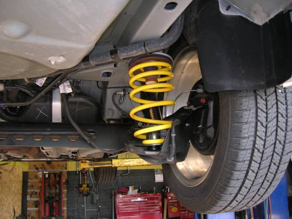

I also have a set of the Goldline Rear Leveling Springs on my 2006 White 2LT and simply LOVE the ride!! Purchased mine from www.TruckShop.com.
I installed my leveling springs in the spring of 2007 and have had no problem with noise or thumping at all.
I did trim the bump stops when installing them. (see picture 2)
I also installed mine with the small spring coils near the bottom with the larger wider coils near the top (just like the stock set-up) when I saw pictures of some of the other leveling springs installed with some binding of the larger coils on the bottom.

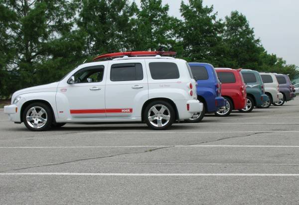

Here are a few pictures of before / during and after install...
