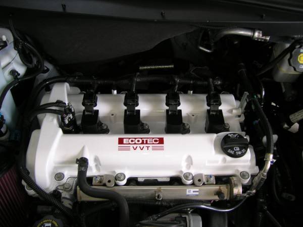

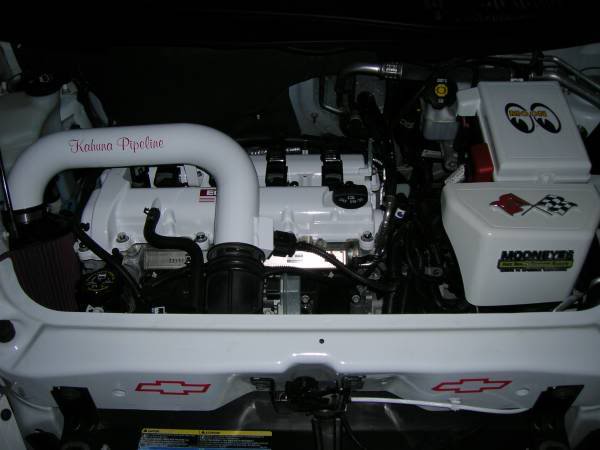

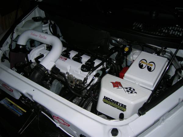

I have always had a lot of luck with a bit of Simple Green and/or spray degreaser on a microfiber cloth. Try to keep up with it frequently so it does not get ahead of you.
Talk about keeping an engine area clean...
You ought to try keeping a white engine and engine compartment clean.
Now THIS takes a bit of extra work but all worth it in the end...
