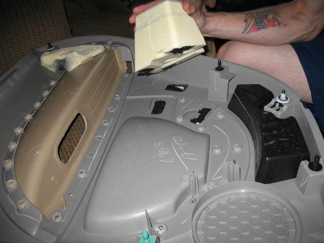

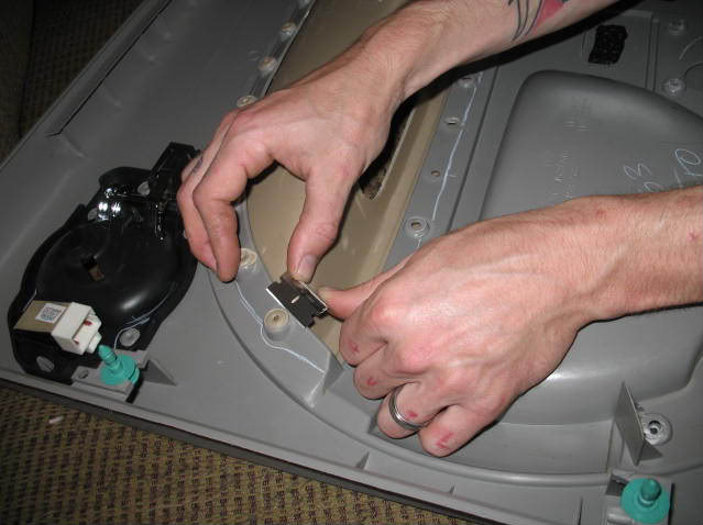

my husband and I just removed the silver trim on the door panel this week. Covering the door with tweed and painting that piece. Its plastic welded to the rest of the door panel with plastic rivets. Theres a post about taking apart the door panel but they recommend using plastic clippy things and drilling through the front of the door?? we used a double edged razor blade and cut the top of the rivets off. using self tapping screws to secure everything back together. have pics if you are interested.

cut the rivets with a double edged razor blade, just enough so they break loose.

in case you wanted to remove the lower door pocket also, foam piece pulls right off

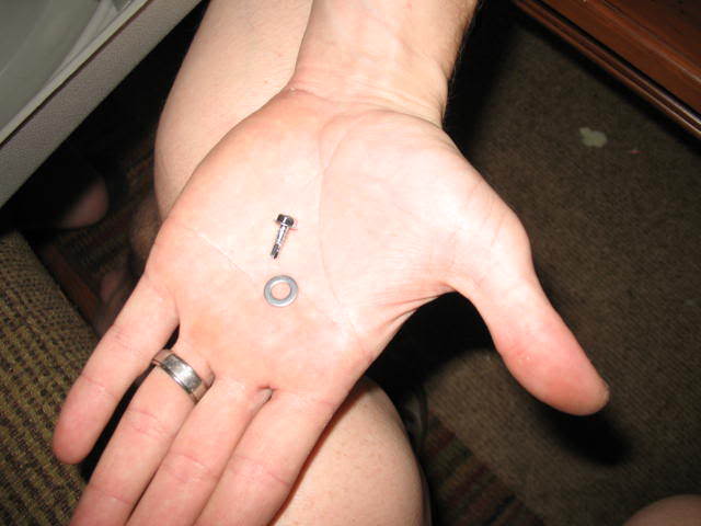

we used a self tapping screw with 1/4 head and a washer

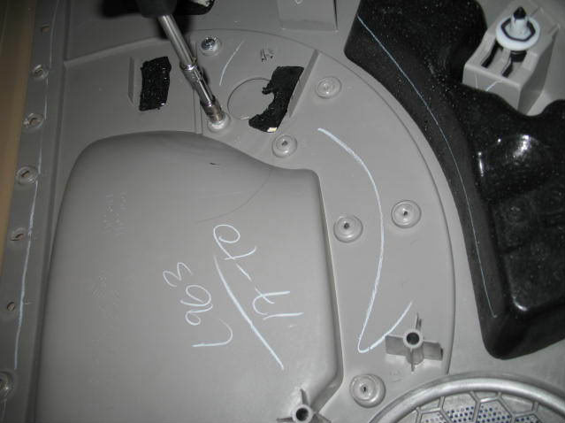

reattaching the door pocket with the screws.

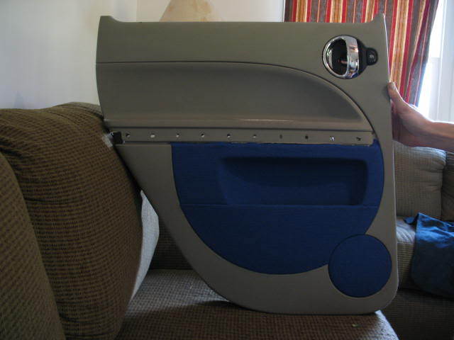

front of door panel with middle piece removed for paint! when the rivets are cut and you can pull that away, theres a clip on the end of the curved part for that piece that have to be removed also.
