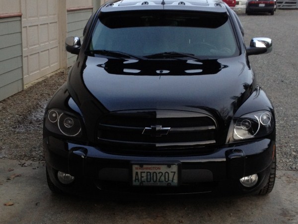

And SS Fan, that looks pretty wicked! Just gotta get rid of the chrome on the mirrors! I just got a pair of GM brand mirror covers in plain black plastic on ebay for $35 shipped. I started sanding them smooth yesterday so I can paint them gloss black! Can't wait!
