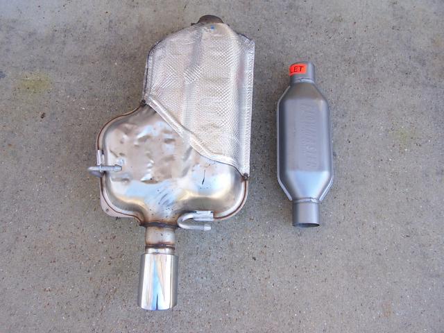

Easiest way is to cut off that restrictive garbage can sized stock muffler and replace it with a small performance style one. It won't "mess" with the computer.
This is what I went with on my SS. No drone sound that you get with some aftermarket mufflers. Saves some weight also. Description is in my signature.
Attachment 16631
The stock muffler ISN'T restrictive...
It's a straight-thru muffler, using 2.75" tubing...
The stock resonator, uses 2.5" tubing, & the tubing to the muffler is also 2.5".
GM did a wonderful job with the HHR SS exhaust system.
The restriction point, for all out performance, is the 2nd cat...
By simply 'coring' the 2nd cat, I ran 12.4s at the track, with the mods in my signature...
