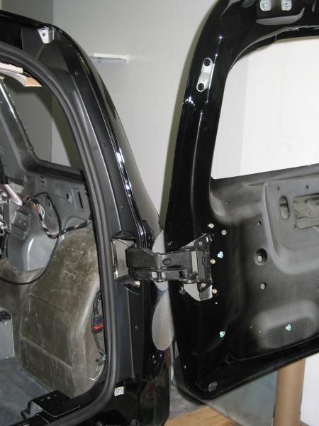

Barn door update
Well, here's a couple update pics...finally! First one shows door open to first detent on hinge...90-100 degrees. Second is at full open...170-180 degrees. I know, there's only one hinge, but with hidden hinges & the curvature & design of the rear body area, I found it impossible to incorporate the other hinge from this assembly (new body style full size GM extended cab pickup rear door). This is one BEEFY hinge, it'll easily handle the weight of this door. I'm triangulating a square tube structure inside each door to tie into hinge to prevent sagging. If I were to do another one in the future, I'd go with external hinges so two could be used. But, since this is not a commercial van or other delivery vehicle with the cargo doors being opened & closed many many times each day, it should be fine. I chose to go with hidden hinges, that's the sacrifice for stealth Bad news is that I have to put this on hold for awhile & mount the new liftgate I just got so I can put this garage queen on the road! My trusty daily driver finally succumbed to the 14 salty Ohio winters & just isn't structurally safe to drive anymore The HHR will now be my daily driver until fall, at least I can still work on the doors on the bench while I enjoy driving the HHR
