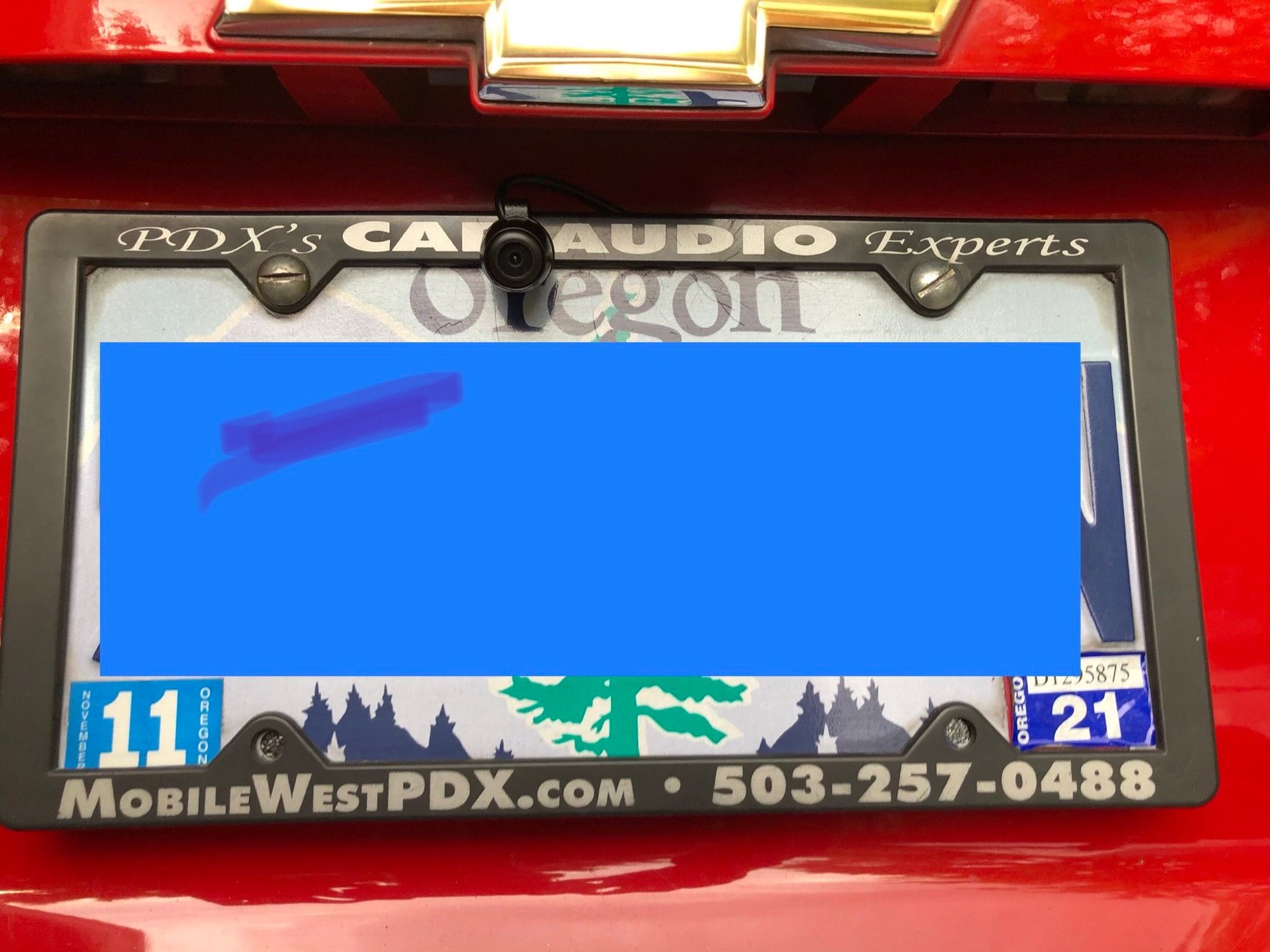

I have up finding an always on power source for a look backwards when not in reverse option, and just wired into the reverse light power.
I had this license plate camera which is not super ideal with the position of the hatch release, so I shifted it a bit to the side.
I used the existing sheet metal hole for the license plate rubber bumper as my cable port.
im driving it for a few days before putting the panel on just to test things.
Camera over the ‘r’
Head unit lines are adjustable so I can shift due to non centered camera
