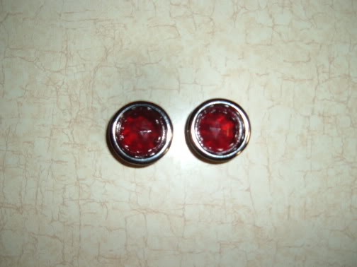

Hopefully it's nice this weekend so I can put these bastards in.
They are glass not plastic of course. I will let everyone know how easy it is to put them in. Maybe do a how to if I have the patience.

Do you just drill a hole in the lens and snap those in?

Yeah sort of, it's not quite that easy though. :) I really wanted blue dots but I know with my luck I would be getting pulled over left and right because they are illegal in NY.

Captain; you'll have to pull the entire taillight housing out to get the lens off. (Unless you want a bunch of plastic chips inside your reflector area?) Most Blue or Red Dots need to have the metal prongs bent over on the inside of the lens to hold them in. I'd set aside a couple of hours at least...

Yup, they came with instructions. The only part of their instuctions I am going to modify is that I am going to add a bead of clear silicon to make sure no moisture gets into the lens. Of course the instructions don't tell me how to take my tail lights out, but I can figure that one out on my own.

No, little red glass jewels that cover the bulb in your taillight.
