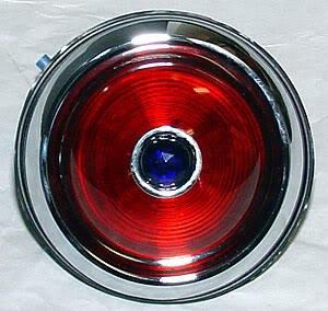

For some reason I wasn't thinking and didn't post an example. They will look kind of like this but in red so I don't get pulled over on the regular.

are these the same thing?

It looks like it kind of, but those look like they are one piece. The ones I have are two piece, the glass piece and the trim ring. I don't really like those, I'm trying to rid myself of bowties.
