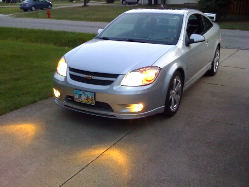

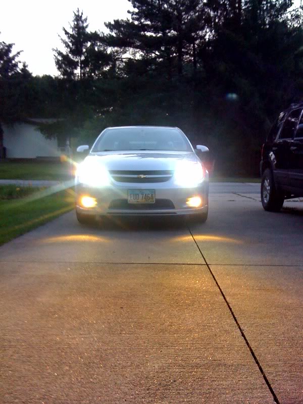

Fogs are 35W. They are 4300K HIDs. Great light output.
This photo was BEFORE I adjusted my fogs at all... WAY WAY low. The origin of the beam was on the ground literally 4 feet from the lamps.

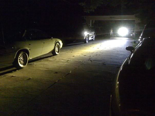

I did my Cobalt a while back too. Headlamps on it were 6000K (cast a funny blue on white reflective paint in the road... wasn't a fan), and my fogs were 3000K-BEST for cutting through rain and fog.

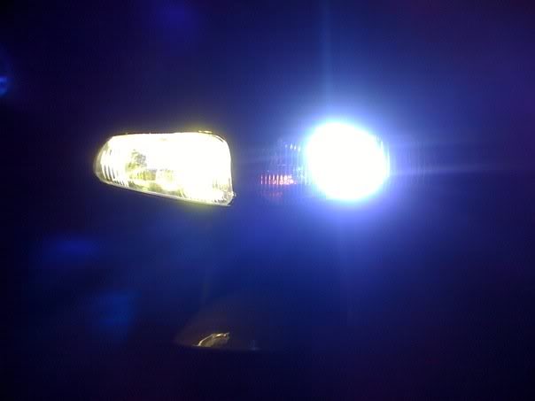

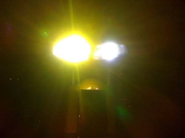

I have a 6000K and a 3000K on my bike too
As far as burning up your housing, its possible. The factory lamps are 37 watts. 35W should produce less heat... essentially the wattage IS the heat produced. So, if you have 55W lamps in a housing designed for 37W lamps, you will make a LOT of heat. Again, melting the housing IS probable.

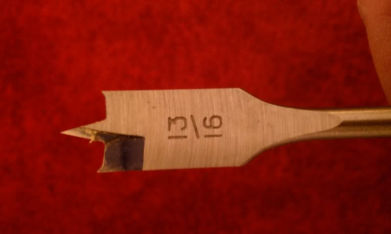

If you have a round push-button fog switch, this type and size spade bit cut the perfect hole.

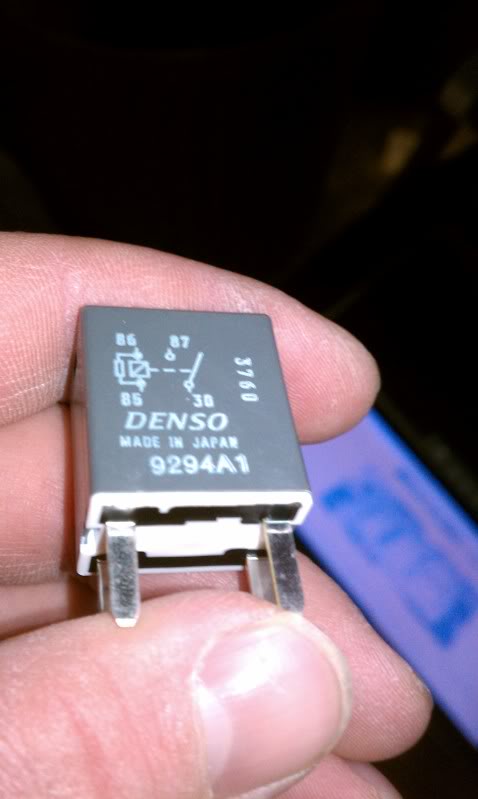

If you're programming the BCM to work like factory, this is the actual relay you need for inside the under hood fuse box.
