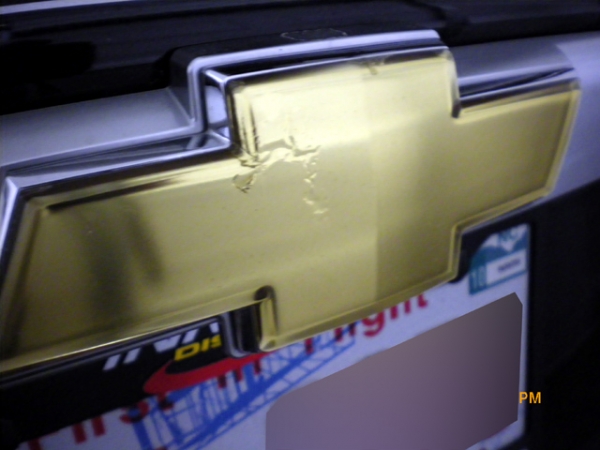

I got my new rear one the other day from Chevy. They were nice enough to let me take it home, remove the rear one myself, and then bring the damaged one back. I hate the thought of having a tech pry it off, probably with a screwdriver. A little heat and monofilament line, and off it came.
Here is what I did for the moment. As I have not decided what I want to do with the front and rear bowtie, I decided to try and weatherproof them a little. I utilized electroncis grade clear silicone adhesive/sealant. It is the one that doesn't smell like vinegar and does not corrode metal, (and electronic parts). I have used it for everything, as an adhesive and sealant. No smell and a great product. Anyway, I went around the seam where the chrome part and the outer clear part meets, right where the water would seep in. A little alcohol and some papertowels cleaned up the excess. I made sure I had silicone all the way around the edge of the bowtie. Now we will see if that takes care of the problem. I did the back one while it was still off the car, and the front one while it was on the car. Both were simple to do.
The product I used was GC Electronics Electronic Grade Silicone Adhesive/Sealant, part number 19-155. This stuff is great to have around the house as it can be used for many things. No smell, and safe around electronics.
