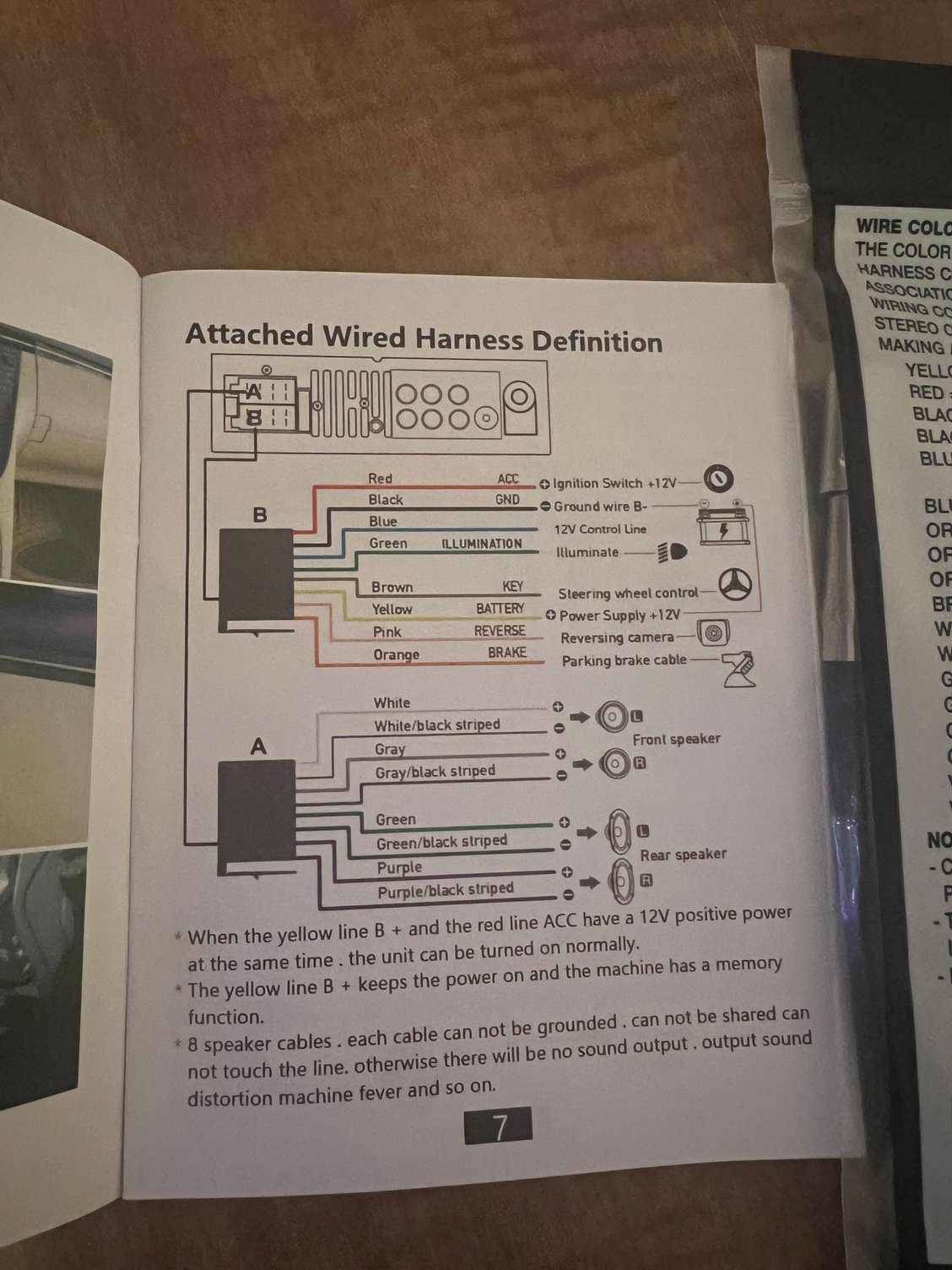

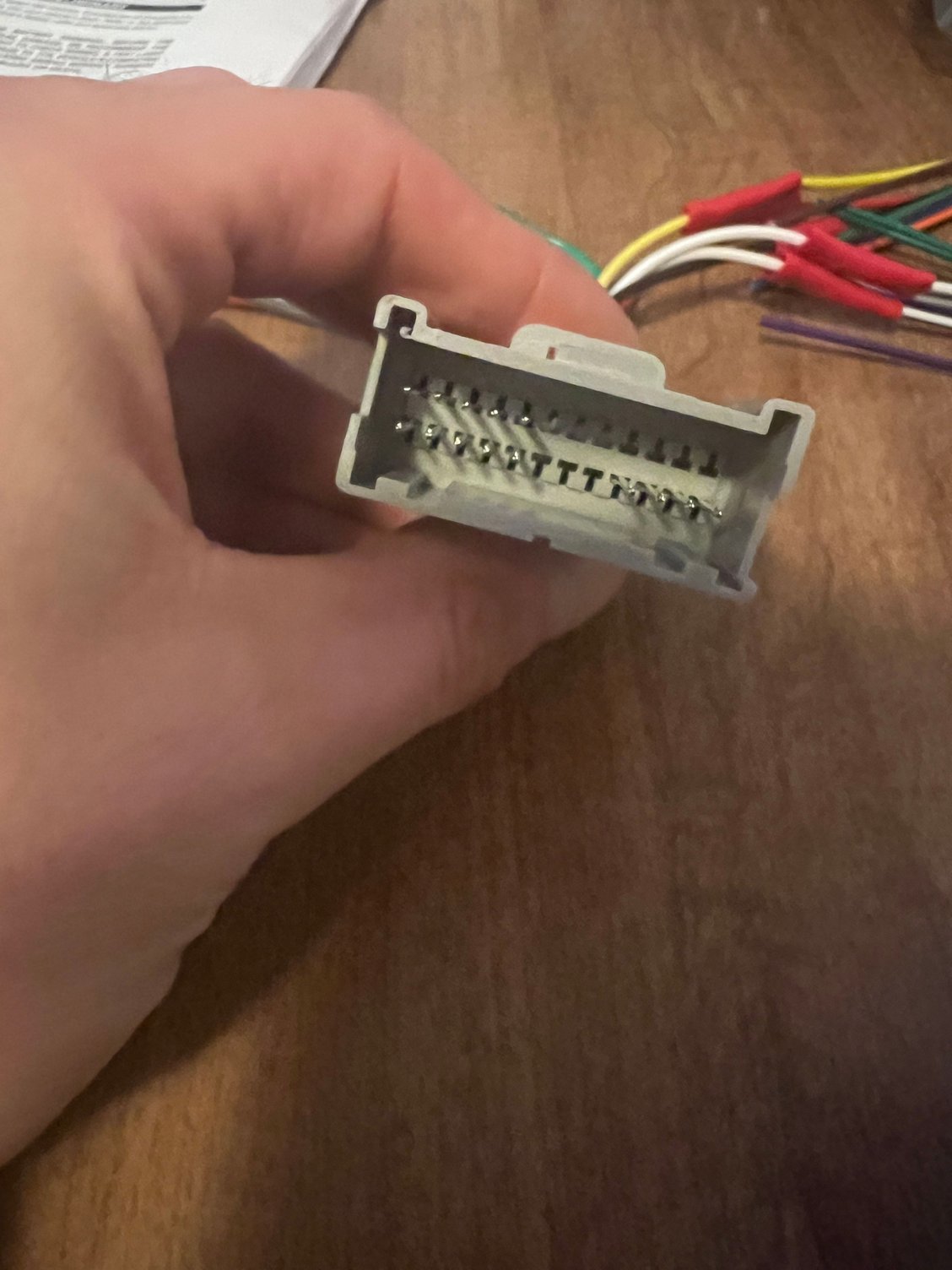

Hello,
trying to install a new head unit in my 06 Hhr (no on star or premium audio). I’ve got the scosche kit and I’m just not sure if I can match the colors to the harness from the new head unit? I wanted to follow the harness diagram from GM but that connector looks different than what I got from scosche and don’t trust the pinout because of it.
i didn’t get the module to retain steering controls or the door chime
any suggestions are much appreciated!!

Old Dec 2, 2023 | 06:39 AM
Posts: 40,096
As we see in the directions, the plug marked B includes the connection to power and lights , and other features including steering wheel controls , so yes the lan is essential to the installation
Old Dec 2, 2023 | 08:06 AM
Posts: 26,541
There are a few reasons to use the adapter. There is one for steering wheel and without.
There is no switched (ACC) wire in the car harness. If you really want to you can source that from any of the "unused" fuse positions on the BCN.
Without the adapter you will not have turn signal clicks or other audible warnings.
If you know what you are doing on 21st century cars that are digitally controlled you can install without the adapter. This forum has a few horror stories from folks that thought nothing has changed since 1990. Look through the audio-video forum, I know that wiring diagrams have been posted several times with advice.
