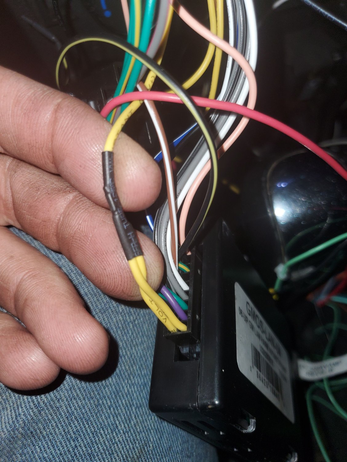

So stock radio has taken a poop on me...... so jumped and got a pioneer av120bt. The gmos lan 04. Ran it wire for wire, but car turns on to security and won't start..
07 lt, no on star, factory sub and speakers. I know this interface is used for one with installing, but I figured that didn't really matter.... im guessing it does??
Also weird relay was wired in the middle of this wiring kit.. I got the kit used,, so not sure if it is supposed to be there or not..
Relay between yellow wire and brown with white stripe.
1 yellow wire, soldered to 2 yellows.
assuming onstar plug
interface
back of head unit
