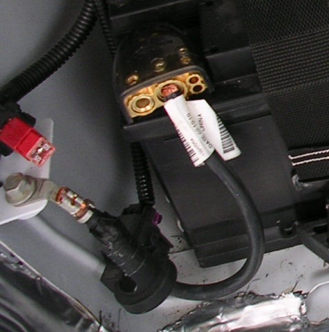

1. What is this little black thing? I've heard that it regulates the charging, so I'm wondering if I need 2 of them.

Here is the little charging thing I am talking about.

That thing monitors the voltage or amperage that is passing through it ,that's what I was told ...
