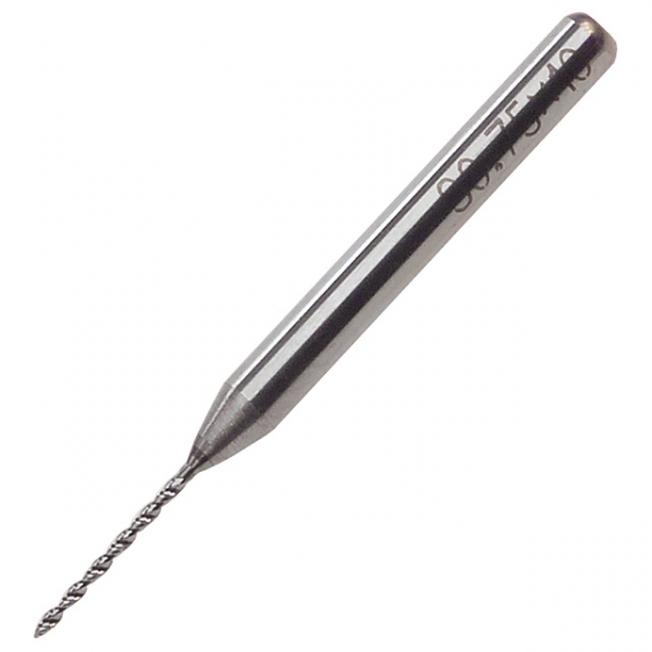

hope you have a steady hand. what about a really big neodynium magnet. prolly would pull it out. short the radio prolly too or just straigt up pull it outta the dash. try some high pressure air. that might work too.

Originally Posted by Jeff®
Forgive me...what is that thing?
Extractor, you screw it into the broken piece and pull it out.
But it would probably do more damage than good. You would have to use some pressure to make it dig into the broken tip.

i can see from the photos that you did break the entire tip off in there and of course that is where the aux jack "holds" on to the plug. The extractor above would have a good chance but you would have to put some pressure on it, and then in return the tip would probably just spin in place...
If i was out of warranty or did not want to talk to the dealer about it, here is what I would do.
I would remove the radio so I could get a better look at it (super easy and lots of how toos on here. I took mine out in about 2 minutes flat...). Now take a good look down in there, light it up good get a magnifying glass, whatever, see how much clearance you have to get in there. I would then take a small nail, smaller then the hole, but get something strong, use a file to put a small notch near the tip. Mix up a small amount of epoxy, probably as quick setting as you can get, 2 minutes or so, dap a small amount on the tip of that nail and get it in to the notch (so it can grip on the nail, you just want to loose the epoxy in there too) and stick it in there and hold it on the stuck tip. Try as hard as you can to not touch anything but that tip, hold it there. if it says 2 minutes, holed it for 10 or more, let it dry nicely and then pull that thing out.
